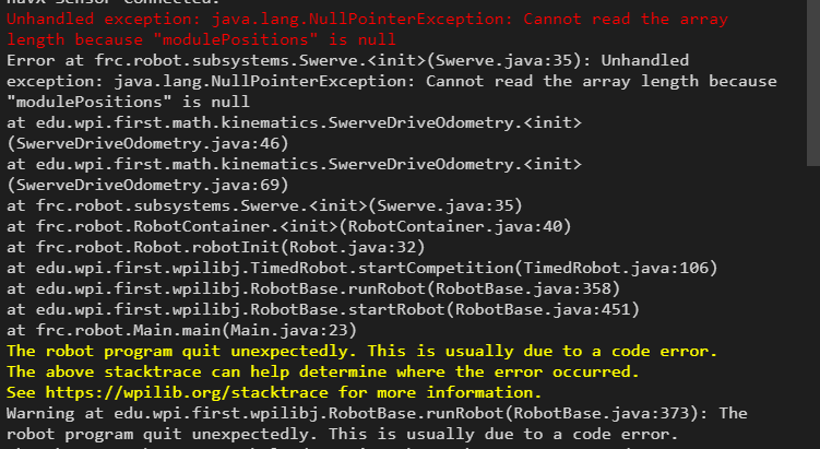

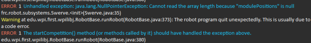

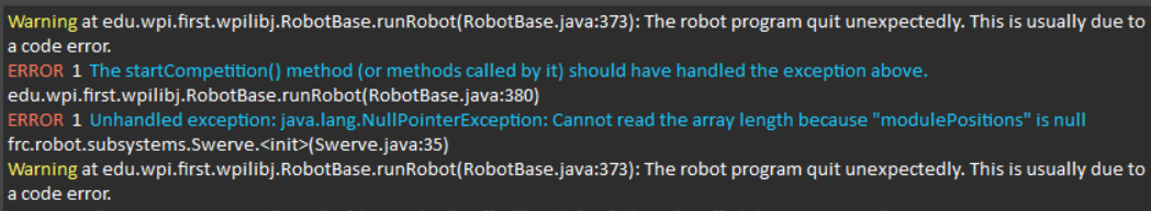

Our team has been trying to get swerve drive up for the off-season but we keep encountering the same error. Could anyone please assist us as we cannot find any resources to troubleshoot this error. Below are some pictures of the error on DriverStation and a GitHub to our code. Thanks again!
You’re initializing the SwerveDriveOdometry object with null instead of an array of SwerveModulePositions. Relevant line here. Notice how the line number (35) corresponds to the error message.
Instead of null, pass an array of the current module positions. More information here.
