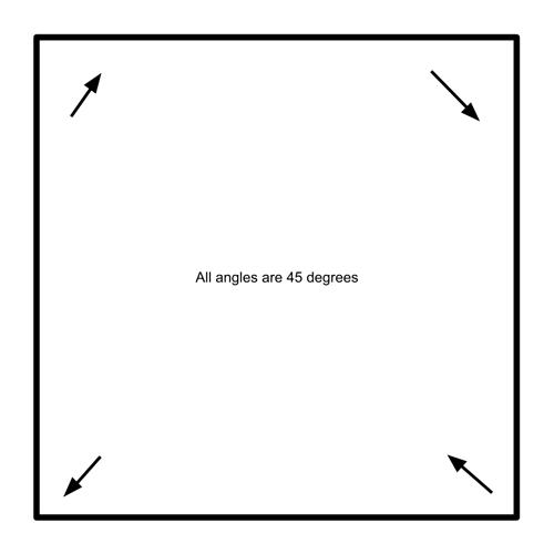

I am having a problem while trying to rotate in a spot as shown above.
Everything else is working.

can you post the code where you declare the swerve modules?
have you double-checked that the motor variables in code and on the robot correspond correctly to each corner? it looks like the back left and back right may have been switched. but more info is required to verify this.

I solved it by just adding a multiplier to x2
Turning is just slow with my code
The maximum speed allowed for translation and maximum speed for rotation and how the sum of translation and rotation is proportioned to the maximum speed of the motors is arbitrary. Pick what works for you.
And that ratio of allocation can be changed dynamically depending on the speed of one or the other if you want varying performance curves such as if I’m translating fast don’t allow fast rotations.
You can see that if translation and rotation both have numbers (from the joysticks) around one then they are treated roughly equally.
