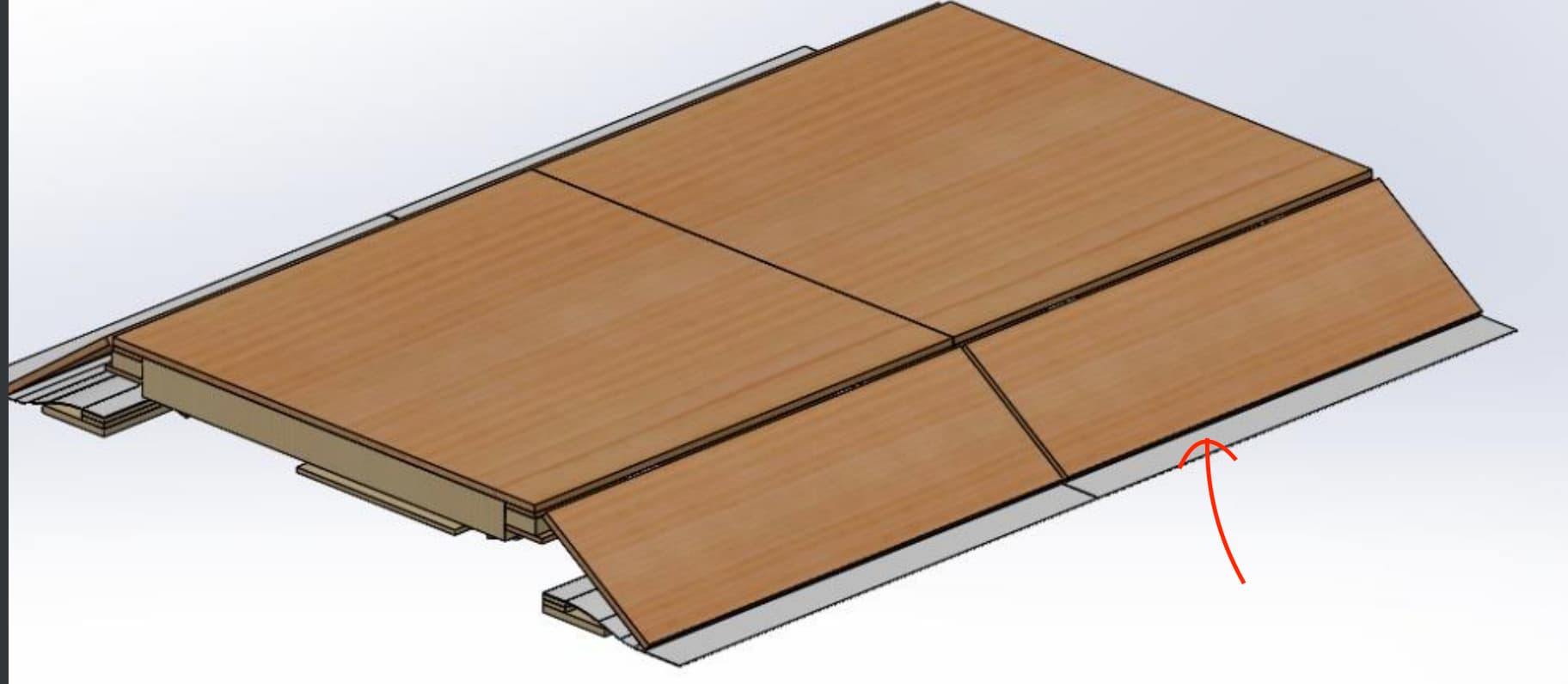

Our Swerve Drive MK4i modules can’t get over the Charging Station, even when the robot doesn’t have bumpers.
We constructed a charging station using FRC’s instructions: https://firstfrc.blob.core.windows.net/frc2023/FieldAssets/TeamVersions/ReadMe/TE-23300-ChargeStation-ReadMe.pdf
The charging station is just missing these metal sheets on both sides of the station:

We wonder if the lack of metal sheets on the charging station hinders our robot from driving onto the charging station.
What are your robot’s dimensions and weight?
Those sheets aren’t metal, but a slippery FRP material. What floor surface are you testing on? The FRP sheets allow the ramps to slide, if you’re testing on a carpet floor or similar that would introduce a lot of friction. We’ve found that even with the sheets it can get stuck if we’re not careful about the setup.

26"x26", 63 lbs. We tested it on a smooth floor (not as smooth as marble though), however, the robot would push the charging station a few inches. We tested it on a carpet, but the carpet seems to have too much friction against the charging station’s ramp.

Have you placed a thin sheet of polycarbonate on top of the ramp?

We noticed a drastic difference in friction coefficients between an unfinished plywood surface and polycarbonate. The bumper would stick to the wood and push it forward rather than down.

My guess is this is the problem (the ramp).
When you tested it on the smooth floor, you could not engage the ramp because it slid out. When you tried it on the carpet, for whatever reason, the ramp bound rather than engaged (creating the proper approach angle). I would not be surprised if it was due to the hinges binding somehow. Mind you, this is all conjecture.
If you have a wooden charging station and are that far underweight, odds are you will have trouble manipulating it regardless of drivetrain configuration.
We have a test chassis with similar specifications (SDS MK4, 27" SQ, Ballasted to around 75-80lbs) and a Wooden Charge station with Polycarbonate overlay and our test Chassis will not climb it without help. If someone tips the CS slightly (about 1/4 travel) in favor of the test chassis, it makes it’s way up and on without issue.
The real charging station will have better characteristics (probably) than what you’re used to, though you’re still going to fight a hard battle being so light.

The real charge station is easier to get on than the wooden one, by most accounts. Also, you said you tried testing without bumpers. Have you tried testing with bumpers? We found it considerably easier to climb with bumpers.
We had the same issues with practice charging stations. You need to have it not move at the base but allow the ramps to slide easily. Otherwise it just wont function as intended.
