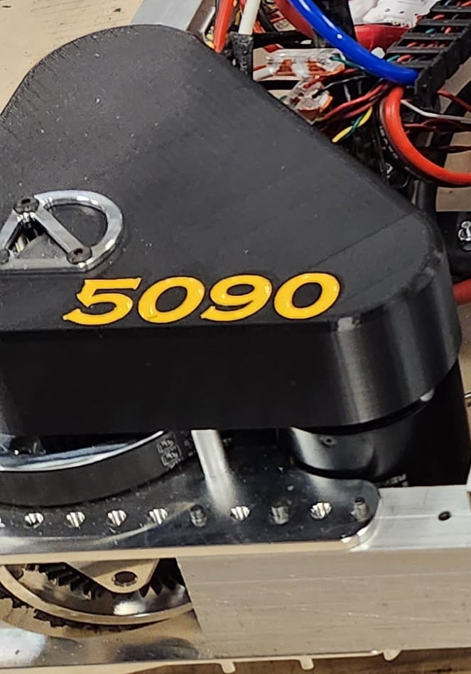

Edit: The only concern we had when going with the mk4i was the open-ish gears on top and something possibly falling into them. That was quickly solved when one of our students designed and printed these. They worked great and look sharp in my opinion. Extending down the sides was two fold a guard and a grease flinging shield which was not an actual issue like we originally thought it could be.
