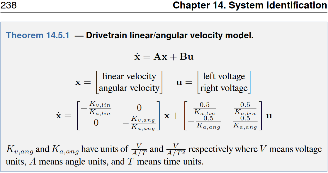

Have you tried finding your angular Ka that describes the acceleration characteristics for your robot when spinning in place? If you haven’t yet, that might be a good place to start, that way you can at least compare the 2 values (I think you should be able to make a direct comparison?)
We used the linear and angular Ka(s) for our robot to calculate for an experimental moment of inertia.
Run SysId with the modules oriented to spin the robot in place.
You now have two gains: Ka_angular and Ka_linear (from the ordinary SysId run). These together can be used to calculate the moment of inertia of the robot, and determine a full(er) model for the swerve drive.
I won’t quote the formula here because it’s dimensionally-laden, but @calcmogul should be able to direct you to how to use the gains in code to control the thing. I believe there may be a code handle that takes them directly (there is one for differential drives).

At least for a differential drive, the evolution of the linear and angular velocity are decoupled. Whether the input is decoupled depends on the input vector choice (e.g., voltage vs acceleration). Maybe something similar will work for swerve.
