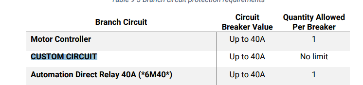

That’s illegal
R610 *1 breaker per circuit. All circuits, with the exceptions of those listed in R615 and R617, must connect to, and have power sourced solely by, a single protected 12VDC WAGO connector pair (i.e. the load terminals, as shown in Figure 9‑10) of the PDP/PDH, not the M6 cap screws.
Sorry, to clarify, I meant individually

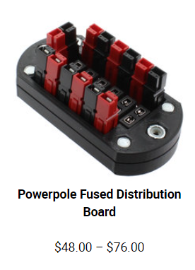

That would depend on how it is wired. Only one wire per port is allowed. If the splice is connected to the two wires before going into the PDP or PDH, it would be legal. I believe the reference was to a lower amp breaker like a 20. There are many ways to make a legal custom circuit. Unfortunately the rules are not all in one place. Essentially there is no limit to extra circuits added to a custom circuit, as long as the correct wire gauge and correct breaker is installed. The limit is what is allowed on the circuit. If you plan on making a custom circuit, I would suggest asking a lot of questions. This Andymark item may also qualify. I hope this helps.
