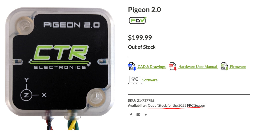

I would just bite the bullet and get a pigeon 2.0. You will be able to use it for many many years, and you don’t have to mess around with the analog devices gyro which we have had problems with in the past. We switched to a pigeon this year and have had 0 issues with implementation or drift.
I’d second this except:
NavX Micro is in stock, but the usb connector is finicky. Be sure to mount it well if you go this route.
The navX says it will be in stock on March 28th. If you aren’t using MXP port on the rio, this is a good choice.
