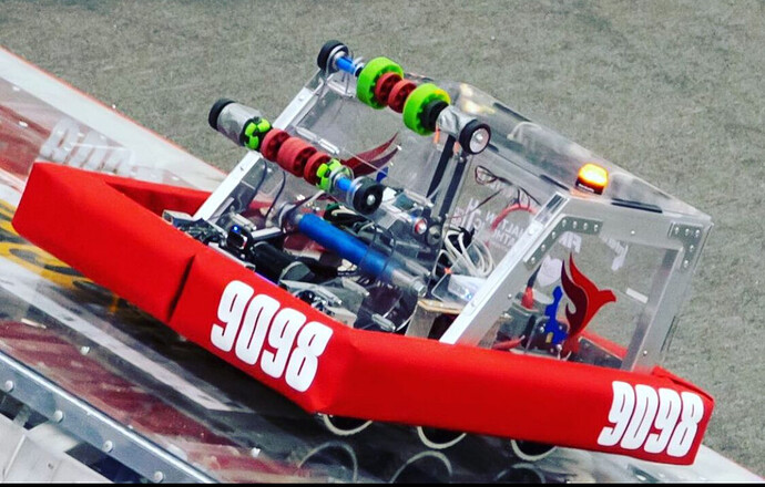

I’m afraid I’m going to be picking apart your reasoning. I don’t necessarily disagree with your conclusion, but your reasoning is… a bit flawed, shall we say?
  1. L.A. Regional has a surprising number of single-event teams–and a lot of the 2-event teams use it as their first event. It was your second event. You had a full event to learn how your robot handled and get good at driving. Some of those other teams barely had it working on arrival, let alone getting practice. Automatic performance boost.
  2. L.A. Regional had a fairly high proportion of tank drives–if you take a look at the link @Zaque posted, 14 swerve, 4 mecanum, 28 tank. Again, quite a few single-event and first-event teams, many of whom do build tank for various reasons. (Like no budget.)
  3. I kinda hate to pull this on you: You got lucky. OPR has you as # 9. (TBA regional page, insights tab). I don’t want to say “favorable schedule” because I can’t really pull those stats quickly.
In other words: you did that well by being better than most other tank drives.
And there were 3 above you, none of whom picked you. Of the 14 swerve bots: 4 alliance captains (1, 4, 6, 7), 7 first-round picks (# 8 picked a tank as their first pick*), and the first 3 picks of Round 2. Every single swerve robot came off the board. Interesting. (Ranking, IMO, is a bit of a crud-shoot. Picking order is often “where it’s at” for “how is it really?”)
How about buying a better 6WD? They are on the market. Just sayin’, you ain’t gotta buy a swerve to buy improvements. Or even a mecanum (OK, now I’M going to get the hate–for this game it might have actually been a decent option). Kitbot honestly kinda needs upgrades to be more competitive, and it looks like that’s what you’re running if I’m not mistaken. How about buying an elevator kit? (Back in my day “elevator kit” meant “the raw materials you buy to build your custom elevator”.)
You could argue for a return to the “limited COTS” days if you’d like to. I don’t think you’ll get farther than being laughed at by 2/3 of CD. (Full disclosure: Some days I’d kinda like to go back to then. Then I wonder why.)
I’m going to play “one-up” on this. Your sights are too low. World Champion is where it’s at, and I can think of 2 different World Champion robots in 2 different years that could both be a Minimum Competitive Concept**. The key problem I have with this statement is that the robot needs to be as simple as possible, but NOT simpler. If swerve seems to be a required stepping stone, or required part of game play, and you build tank only, you done screwed up!
Suggested thought exercise: do you think that if you’d focused on cones instead of cubes, you would have done as well at scoring the game piece with your tank drive, or would you have needed additional features? (Not necessarily swerve.)
