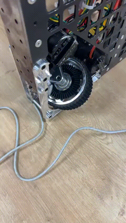

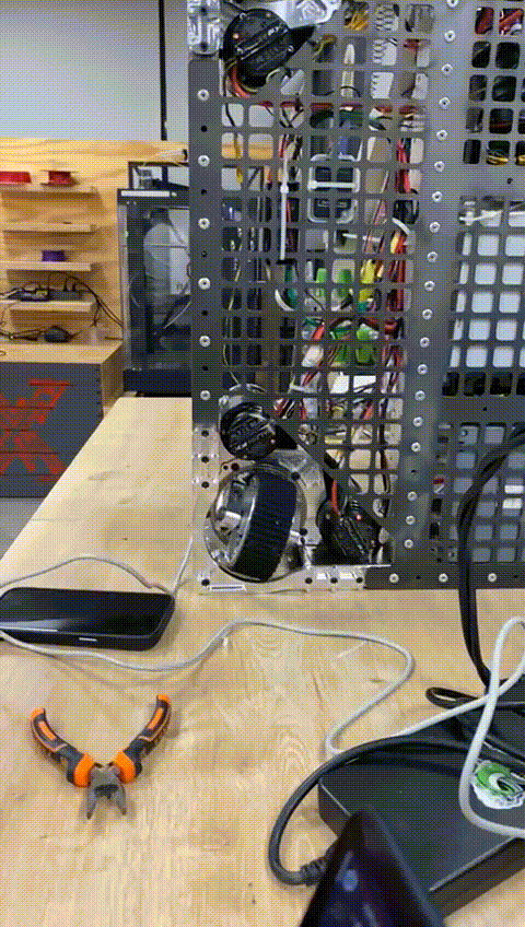

Here is a video of the constant setpoint trial. (The video is in slow-mo and a single PID algorithm is running throughout the whole video. The wheel turns to the desired rotation, then instantly rotates to the opposite direction, and then gets back to the desired one.)
2ea4f8a2-936d-45ed-9a15-914186c50291
Here is a video of a trial with a small kP value:
VIDEO-2023-12-19-20-49-54

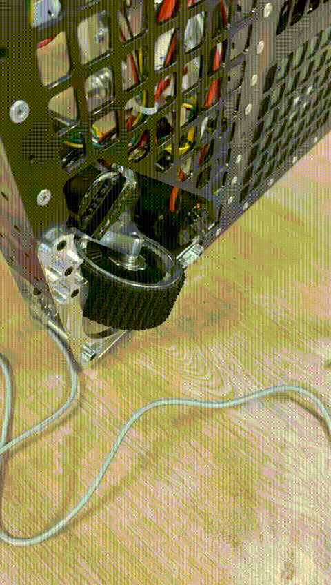

Here is another trial with a slightly greater kP value:
VIDEO-2023-12-19-20-49-09

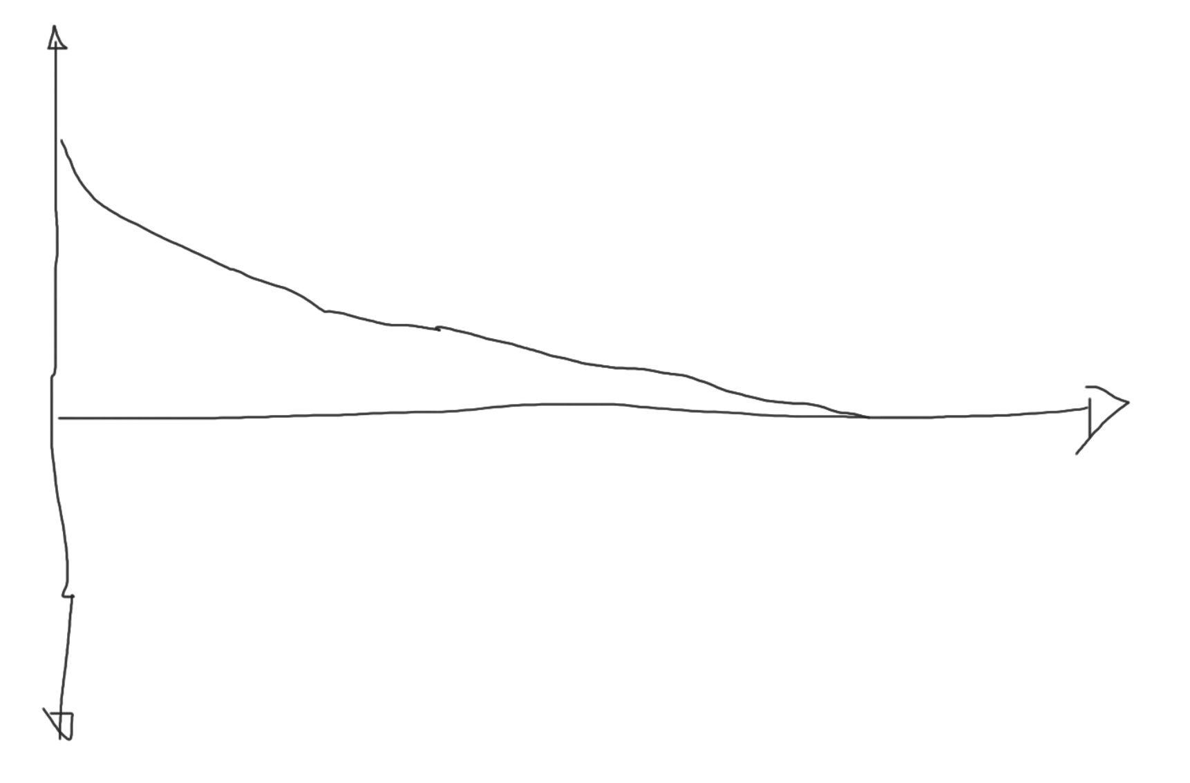

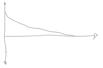

I believe that a proper PID output to the motor has to look like that graph.

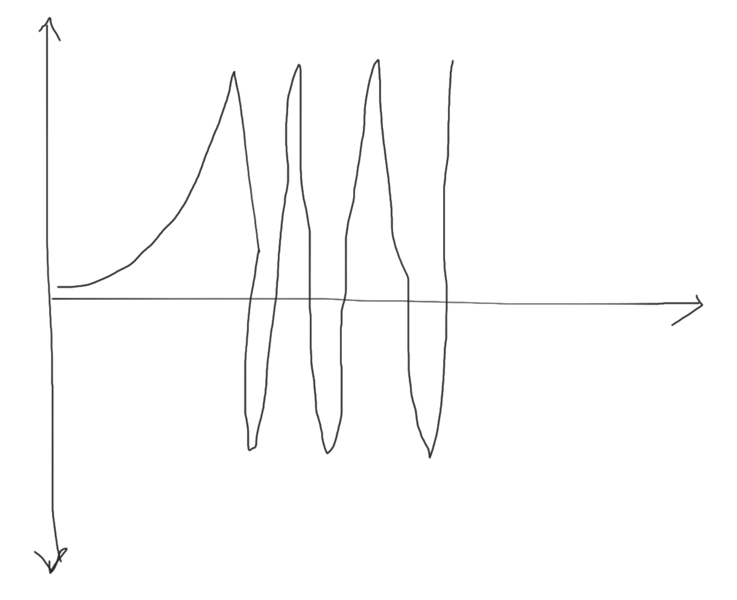

However, according to my observation, our PID output looks like this:

The top image has odd behavior but the middle and bottom images look right - our robot does that sometimes in the air but on the carpet the wheels don’t overshoot their setpoint so much that it has to be corrected. We see on our motors from the motor controller lights that power is still being applied but so little that the motor doesn’t move once near it’s setpoint’s tolerance.
Here is my guess:
If the steering motor has an output which is not in phase with the encoder (meaning positive voltage causes the motor to spin and the encoder goes down instead of up or the opposite) then the motor is going to accelerate away from the setpoint. Then, since the PID loop is circular, once it reaches the farthest point away from the setpoint it switches directions as the circular loop calculates a better way to get to the goal, but again the motor is going the wrong direction so it accelerates the wrong way. It keeps oscillating around the 180degree transform to your desired angle. This would look like the motor is oscillating around the correct desired setpoint because the wheel looks like it is facing the right direction still, but if you applied voltage to drive it would go the wrong direction. Just a guess but that’s my take from the videos

The 2nd and 3rd videos look normal to me if you are only using Kp. I would add Kd to prevent the overshoot.

One thing I want to note about the second and third videos is the motor does not seem to be slowing down as it approaches the “setpoint” which makes me think the direction is wrong
