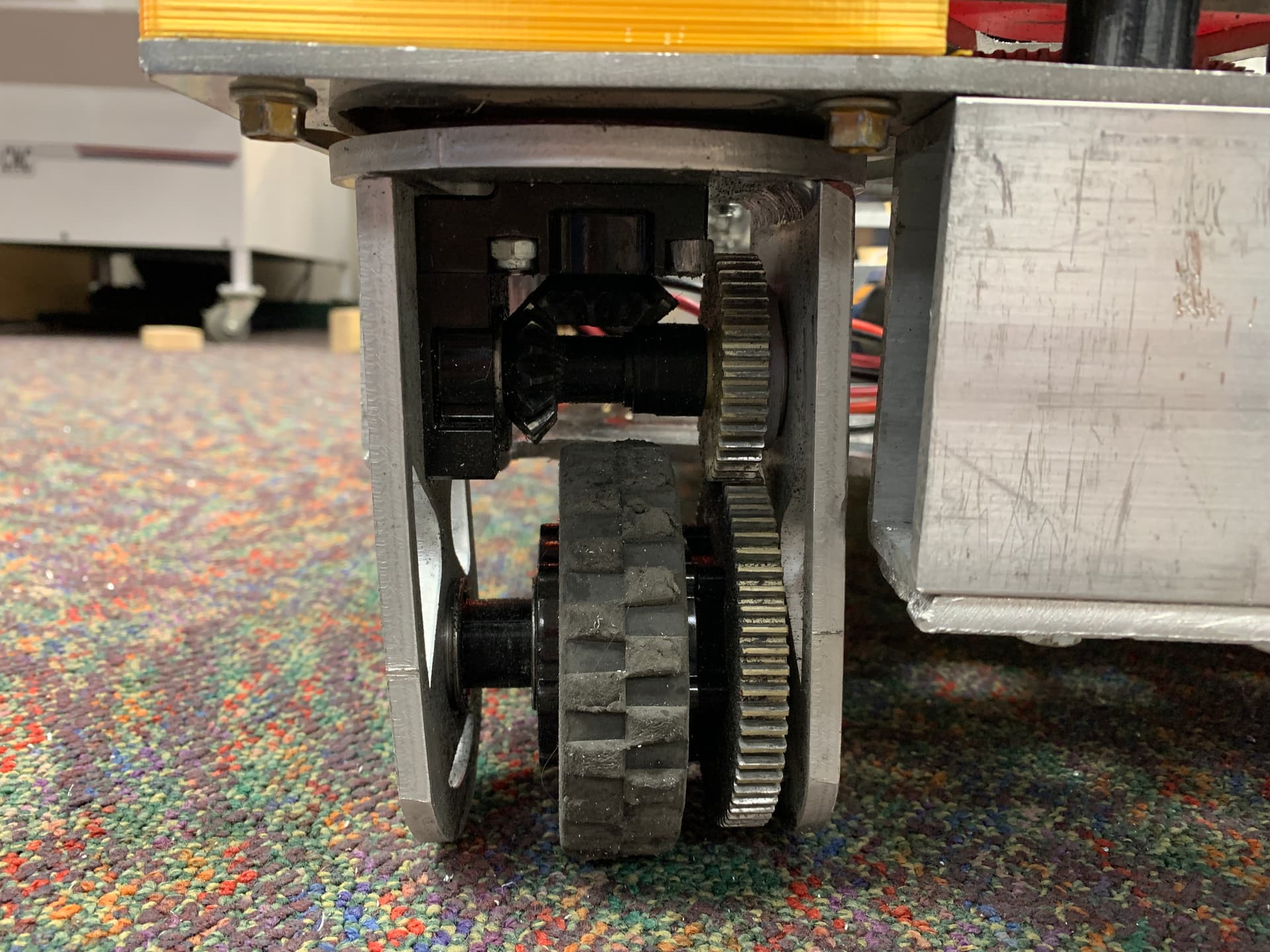

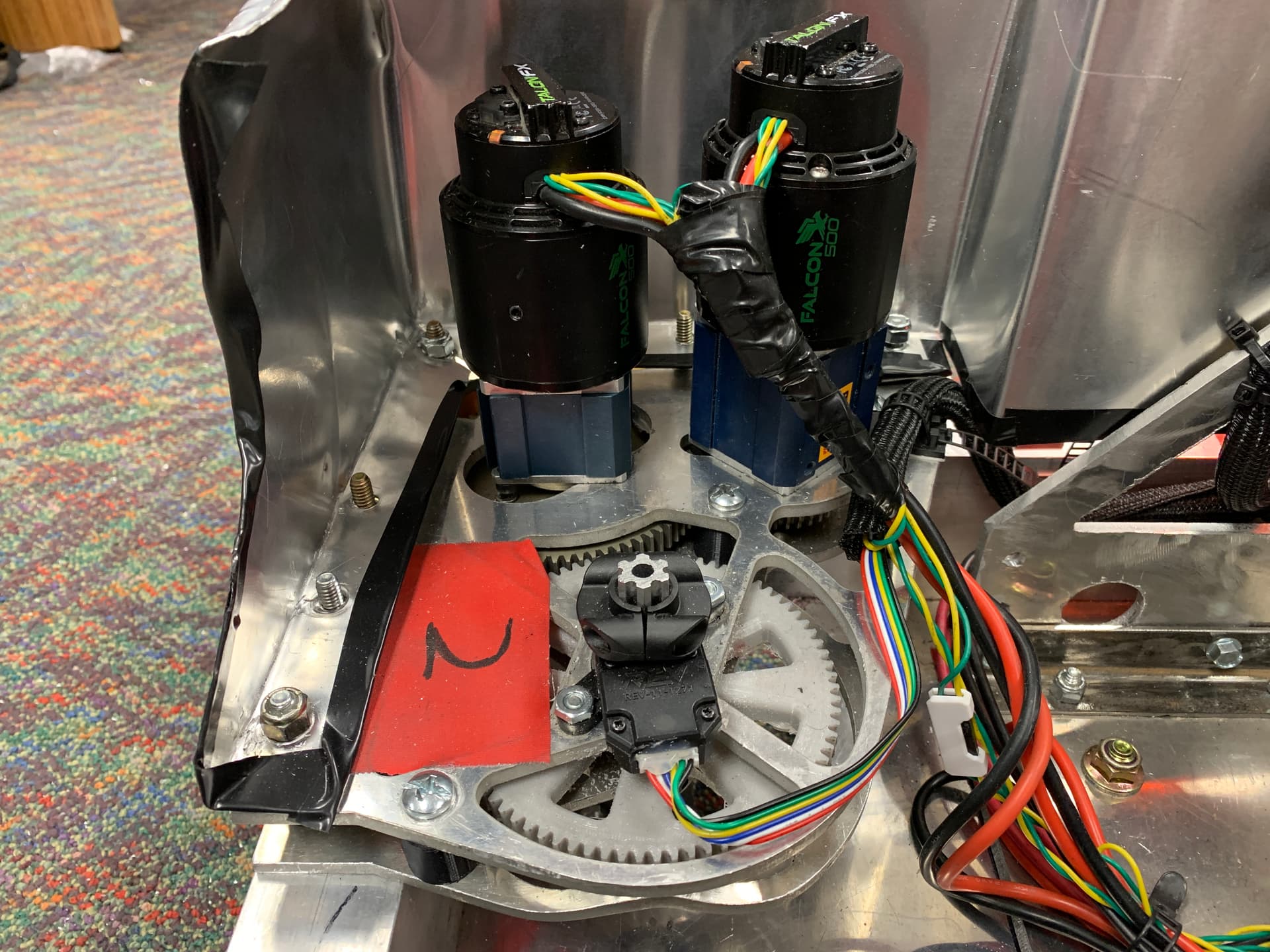

Our modules are a custom setup using two Falcons and Rev Through-Bore Encoders on 1:1 gearing from the steering axis. We have them set up in absolute mode through the duty cycle encoder class. We are using a navx2 for our gyro.

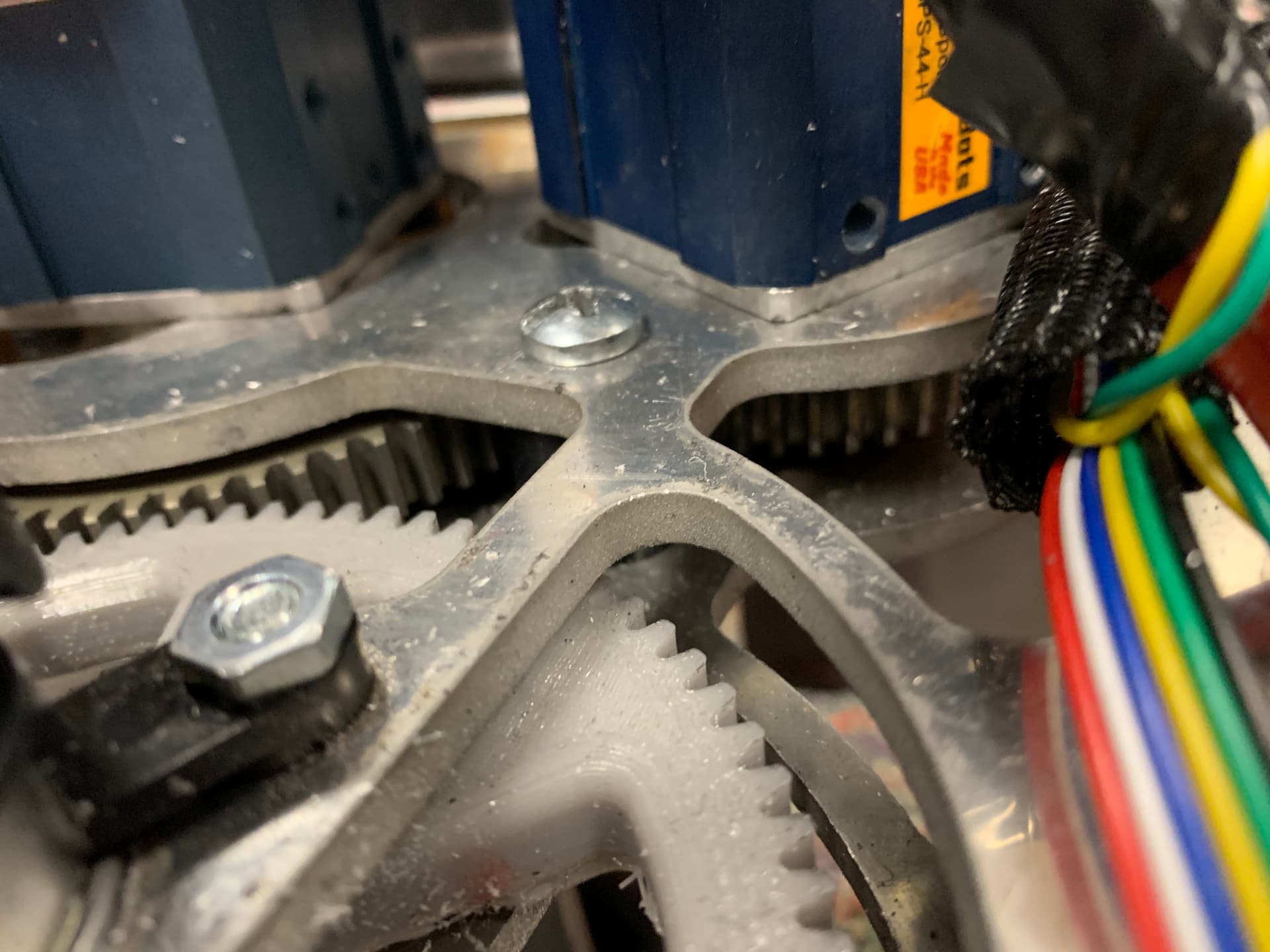

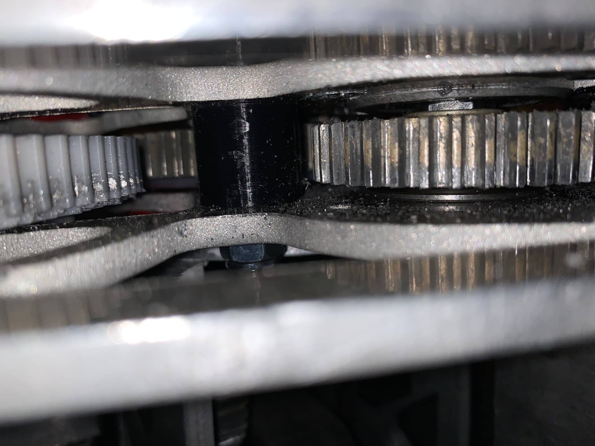

Because of the design of the modules, there is a small amount of slop in the gears the angle motors drive through. This leads to noise coming from the Falcons that keep trying to correct the position when the error is just the backlash in the gears. It doesn't happen with every movement, but will this burn out the Falcons eventually?

Is a belt or gear skipping?
This is a good question, especially given issue # 5. Can you share CAD files or pictures of the swerve modules?

The modules only use gears and are pretty beefy. We’re pretty confident that they’re not skipping teeth.
