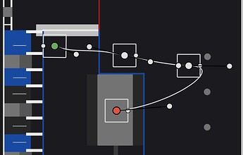

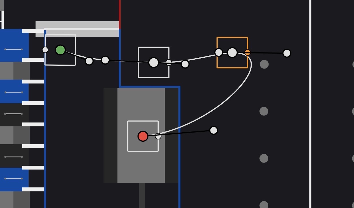

We’re experiencing a problem where our odometry, which we’re logging through AdvantageKit, isn’t aligning up with what’s happening in the real world.
This only happens when we’re running an auto where you turn and rotate at the same time.
We’ve tuned our second order kinematics so when you are controlling through teleop there is 0 drift when you drive forward and rotate, but we could’ve made a mistake with that. With AdvantageKit though it is plotting exactly the wanted path.
Is this just wheels slipping and us losing odometry? I’ve also messed with increasing the P for the pathing command, the module angle P, and the module speed P.

Wanted Path:
Reality:
Here is the fudged path that ended up working:

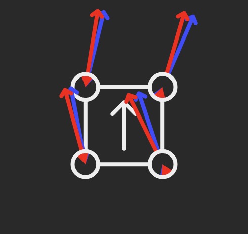

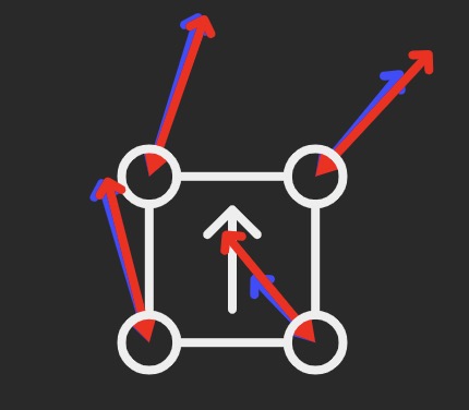

Yep this was developed by my team. The 0.065 was a fudge factor I put in since the second order kinematics only gives spits out the angular velocity of the module, which we are multiplying by a feedforward, so therefore I didn’t see a straight forward way to find the additional angle offset that the module will be off by.
It was mostly done to make the visualizations look better, but I decided to put it in the swerve optimizer for something to test. I had meant to do some deeper testing on this, but since it worked and I haven’t had a lot of time to test, I’ve left it as is.
Screenshot 2023-03-27 at 4.59.23 PM
Base with only reading pure angle position
Screenshot 2023-03-27 at 5.00.45 PM
With fudged 0.065
