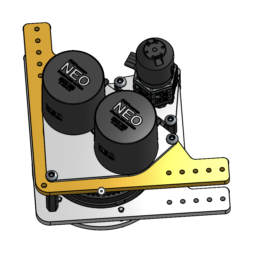

Swerve/omni Hybrid

My Team (7810 Eagle Robotics) Worked on a 12-motor chassis design recently, but it is in a purely theoretical phase right now.
we are looking at getting twelve REV NEO motors but are majorly concerned about power draw, with my basic calculation - running the maximum amperage of the motors would net us roughly 2 minutes of life, but we would cap the motors pretty well below that power consumption.
do you think this design would work?
It’ll probably work with some current limiting and you’ll get the efficiency boost from using multiple motors which was heavily discussed in a few tri motor swerve threads, but you will need to play with current limiting when it comes to spikes browning out your system.
How Limited do you think we would have to bring the motors in order for this to be reasonable with the standard 12v 18AH batteries?
What’s the advantage of this over simply having two motors on each swerve module? The coefficient of friction of omni wheels is lower than that of treaded wheels even when moving parallel to the wheel. Any weight taken up by the omnis has its contribution to the robot’s pushing power halved, because two wheels are perpendicular to the direction of movement. Also, making sure all 8 wheels are roughly equally loaded seems rather difficult (you’ll probably have to use pneumatic cylinders or springs).
I think this is very likely to be worse at accelerating than a normal swerve drive because you have two weight bearing wheels that aren’t driven.
30 amps if you want to smack a limit on everything but I’d recommend doing some more dynamic limiting to keep overall usage fine but still allowing single modules to output more power when needed assuming others don’t need to move very fast at the time.
we are designing two motor swerve modules in-house at the moment - did you mean a three-motor module?
we believe there are two major contributions added via the omni wheels - the first one being acceleration ability, though this is not the primary reason behind this design.
the second, and arguably most important, is a defensive aspect robot. swerve alone is much more maneuverable than tank drive, but lacks the power to escape a push, as you have one drive motor and one rotational motor, where the rotational motor can be “out torqued” and pushed aside by a well-made tank. these wheels allow for an extremely high torque to fight back or escape, and cannot be turned aside.

From looking at this idea, it looks like it would be mechanically simpler to have for three motor swerve drives, while getting the same benefits.
It looks like it isn’t too much work to modify sds mk4is to a 2 motor drive and 1 motor steer design, which both high tide and barker redbacks used. I’m sure it’s possible to modify REV Maxswerve and WCP swerve to have two motors driving, too.

Fwiw, I haven’t seen well made swerve drives being pushed around by tank drives, mainly the opposite acctually.
Swerve doesn’t usually get pushed by tank too much but when a tank drive is horizontal with high traction wheels even two swerve bots fail to push it and it makes defending centre field extremely easy.
Yeah, what I meant was two drive motors, or equivalently three total motors.
What I’m trying to say is that the proposed design will be worse than an ordinary swerve (with 1 drive motor) in both these categories (not even considering a swerve with two drive motors).
Pushing power and acceleration are determined by the exact same thing: how much force your robot exerts onto the ground, and therefore (by Newton’s third law) how much force the ground exerts on your robot. For each wheel, the torque generated by the wheel’s motor(s) pushes against the ground, and the frictional force between the ground and your wheel pushes back on your robot.

Now let’s calculate how much force (and therefore pushing power and acceleration each wheel generates). Let’s say your robot weights 120 lbs. In a normal swerve drive, each wheel carries 30 lbs. I’d estimate treaded wheels have u_f = 1.3, so each wheel generates force equal to 30 * 1.3 = 39 lbs for a total of 156 lbs. In your omni swerve drive, each wheel carries 15 lbs. The four swerve wheels produce force equal to 15 * 1.3 = 19.5, and the force produced by the two omni wheels (Vex says u_f = 1.1, I’m guessing this is high but we’ll go with it) is 15 * 1.1 = 16.5 lbs so 111 lbs total. The normal swerve has 1.4 times more pushing power.
Of course, you have the advantage that you have two extra motors helping you generate torque, so you can gear higher and still be traction limited (or remain traction limited at higher velocities). This decreases your sprint time. However, the benefit is limited because you are limited more by the battery than the motors. So, the main thing you gain is increased efficiency by running each motor at lower current for a given total torque.

There’s a 5% improvement over the full field for the omni swerve at 16.5 FPS maximum speed, and a 11% improvement in minimum sprint time. This advantage goes down for lighter robots, more powerful motors, or a shorter sprint distance.
This is not even comparing it to three motor swerve, which is better in every way.
I would highly recommend running your design by a physics teacher or mechanical engineer if this explanation is unclear.

Mechanically this will be a mess because you are asking the eight wheels to maintain relatively uniform contact force with the floor. If we add suspension it will be a mechanical mess for different reasons.
