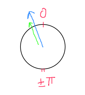

Imagine you are currently in this state, where the blue arrow is the heading of the module and the green arrow is the direction the drive wheel is spinning.

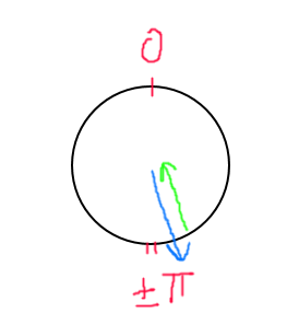

If you want to reach this state:

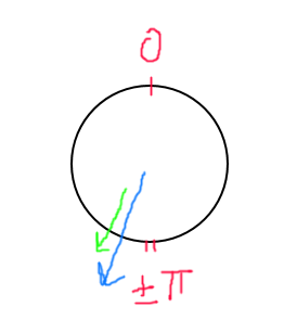

It will be optimized instead to this state:
In this case, the target heading of the module will change from ~160 degrees to ~-160 degrees as the optimization function uses Rotation2d. If your module heading controller doesn’t have continuous input, it will see -320 degrees of error instead of 40.
