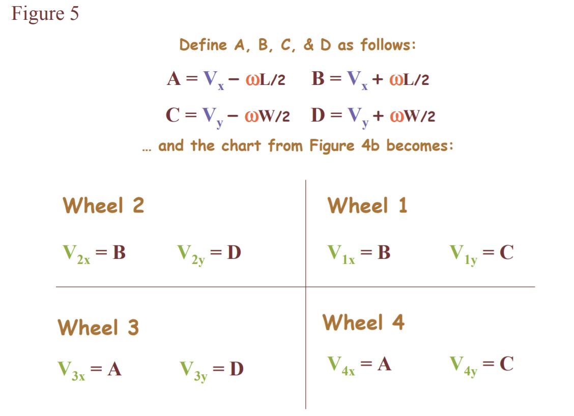

This is our second year doing swerve I copied the code over from last year which worked but when I use the right stick to rotate the robot the wheels turn to the wrong angles
Desired:
Actual:
Here is my current code if anyone knows what I did wrong help would be appreciated.

not much of a programmer, but could you have accidentally swapped the signal for the rear left and rear right pods?
It looks like you haven’t been consistent in the numbering of your wheels:
Here you number them FL,FR,BL,BR for 1-4:
And here you label them FR,FL,BL,BR per Ether’s paper (see pic below)
So i got it rotating to the right angles but the wheels are spinning the wrong direction one side of the robots wheels are turning as if it was trying to turn left and the other side to turn right here is the updated code

I solved the issue it seems I had the wheel speeds for half the robot backwards meaning it was doing it while turning and driving strait.
