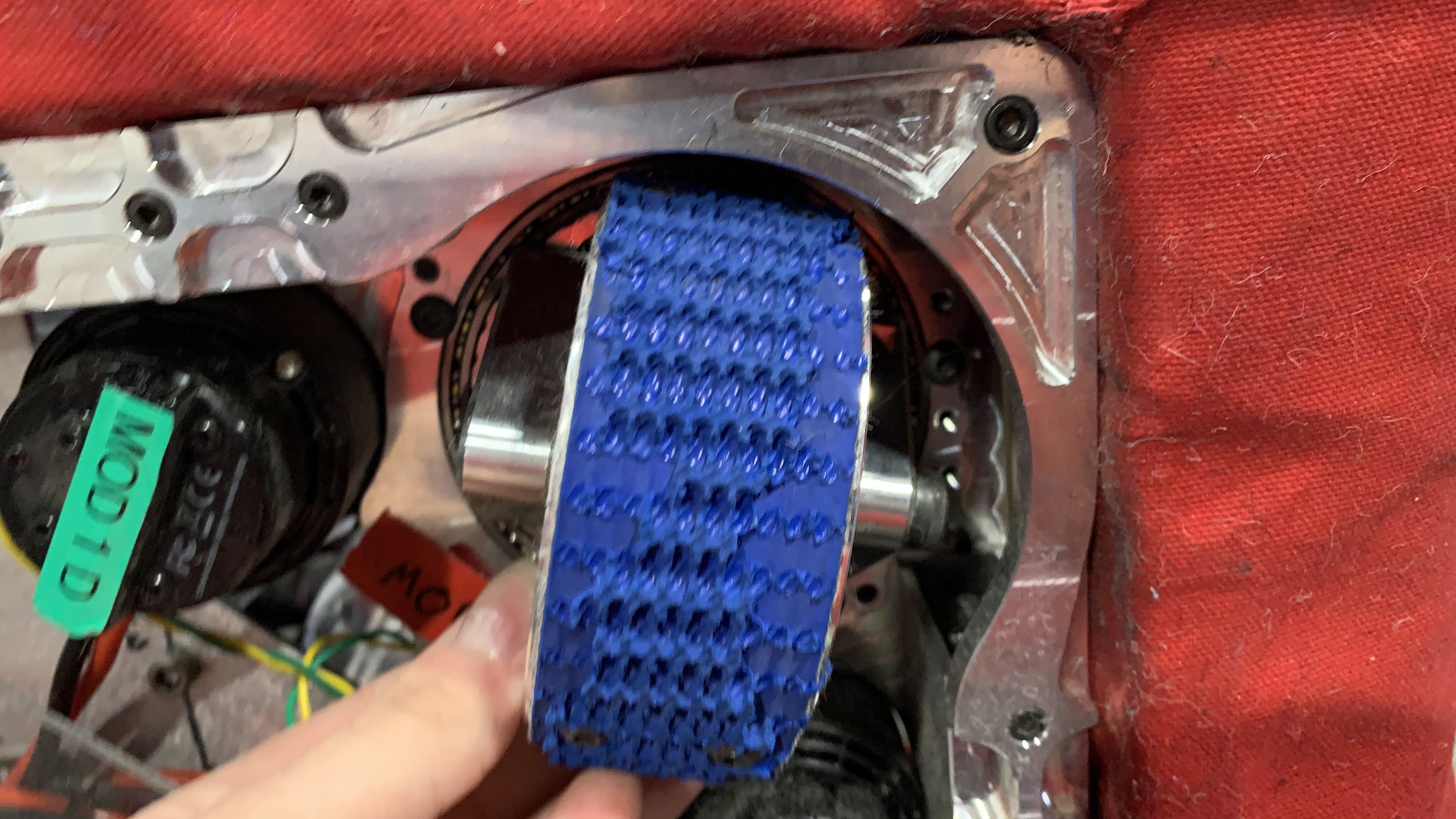

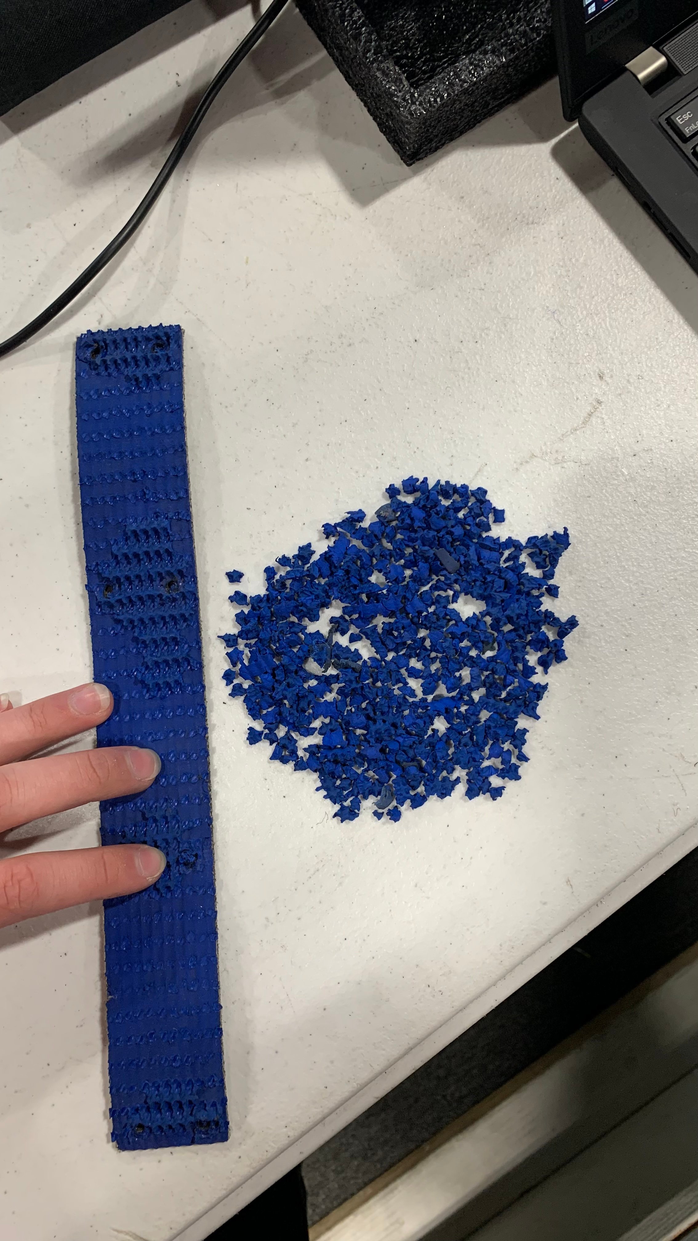

Please excuse the bad grammar of my teammate. Our swerve modules are tearing out tread faster than we have heard about, and we are lacking a solution.
You need to change your treads. The swerve drives eat through the blue nitrile. You will probably need at least 2 sets per competition.
Some things can make tread wear worse. IF your wheels aren’t turning right you will eat tread faster. The encoder reset bug in sds can cause one wheel to not turn which will drag it and destroy your tread. Also fast take offs will eat the tread faster.

We’ve had this problem too. The sides of the treads wear down before the center. Aggressive driving can eat through treads quickly, we replaced our treads before elims and after finals they were flat.
