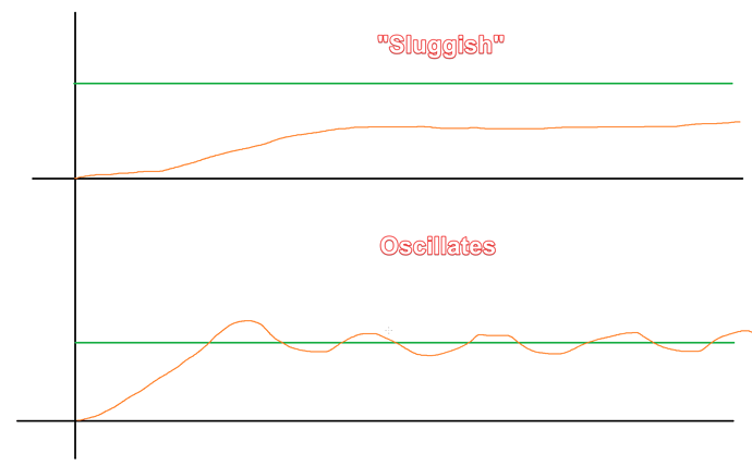

I think I still want to see plots of what’s going on. The nomenclature “Sluggish” or “oscillation” is mutually exclusive to me:
Green is desired, orange is actual.
I’m not certain how a step response could be both “sluggish” and “oscillatory” simultaneously.
I’ve never used Glass before, so it might take me a while before I can get graphs running. What I meant by both sluggish and oscillatory is that some of the wheels start turning after the other wheels, but start oscillating once they reach the desired end state.
