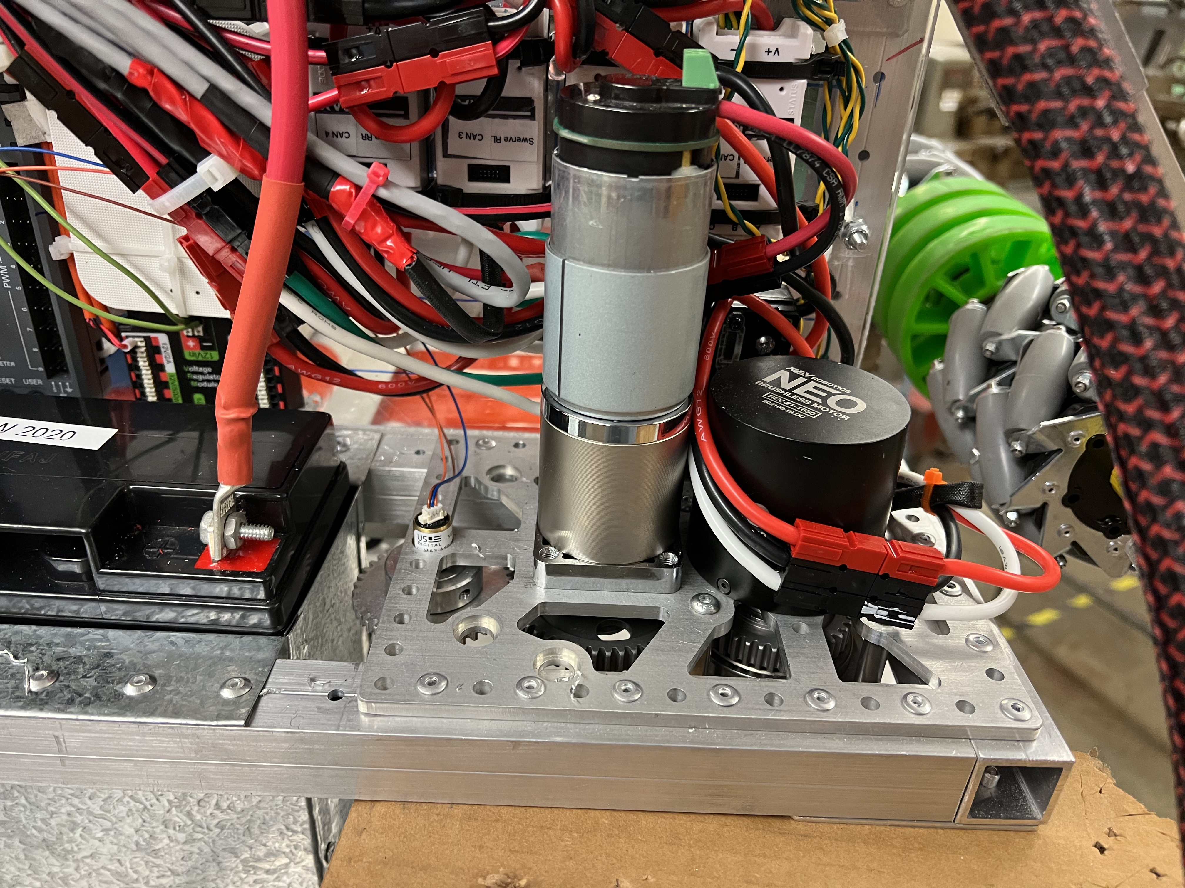

Lastly, can you describe the setup you have for your turn encoders? I.e., what encoder you are using, what is connected to, etc? A picture would help as well.
Hi, sorry for the delay, I’ve checked all the ports and IDs and everything appears correct, we are running andymark swerve and steers (pg turn and neo drive) with the ma3 absolute encoders. All the motors turn like expected and the encoder values all make sense and wrap correctly. I’ve been troubleshooting for days and am really unsure of what it could be at this point. The closest I’ve gotten is removing the optimize function from the code which seems to marginally decrease the oscillation, but it’s still there and the wheels still seem to be rotating strangely.
Here’s an image if it helps. Also, some of the commits I made have some changed port numbers, that’s just from some re-wiring we did, so shouldn’t have affected anything.

Nice picture. This is completely irrelevant to the control problem you’re having, but a Robot Inspector would ding you for:
  • Uninsulated battery terminals (R607)
  • Incorrect wire color supplying power to VRM (R624)
