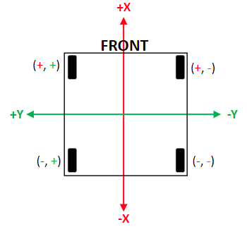

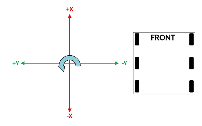

WPILib’s coordinate system is NWU. See the picture below. Positive X is forward, positive Y is to the left, and positive rotation is CCW.
I don’t need to go any further than your kinematics to see that you have this incorrect.
  public static final SwerveDriveKinematics kDriveKinematics =
      new SwerveDriveKinematics(
          new Translation2d(kWheelBase / 2, -kTrackWidth / 2),
          new Translation2d(-kWheelBase / 2, -kTrackWidth / 2),
          new Translation2d(kWheelBase / 2, kTrackWidth / 2),
          new Translation2d(-kWheelBase / 2, kTrackWidth / 2));
Tracking this through your code, the order is FL, FR, BL, BR. The signs on your wheel translations are incorrect. They should be like this:

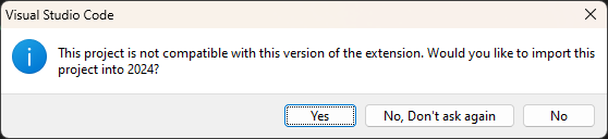

When I open your code I get this message, and I don’t know exactly why. You might want to figure that out:
EDIT: I think that message is because you have "projectYear": "2024beta" in your wpilib_preferences.json file. Your build.gradle file also has older versions of JUnit. I would just run the project importer to get it fixed up.
I also noticed your CTRE vendor libraries are beta. You should update to the latest (and the latest firmware.)
