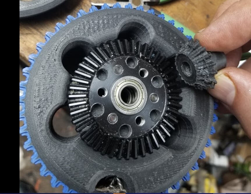

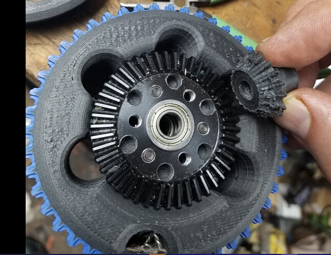

I experimented with using safety wire lacing on the wheels for my clone of Nick Cousin’s winter swerve. Easy to get plenty of tension, not sure if it will transmit enough tourque. Its only driven a couple of feet, so no real results yet…
This test was laced with Copper wire; I also did them with stainless steel wire. Its easier to lace them inside out and flip. I had two tapered hubs that pulled the whole thing tight.
You can -just- see the safety wire:
