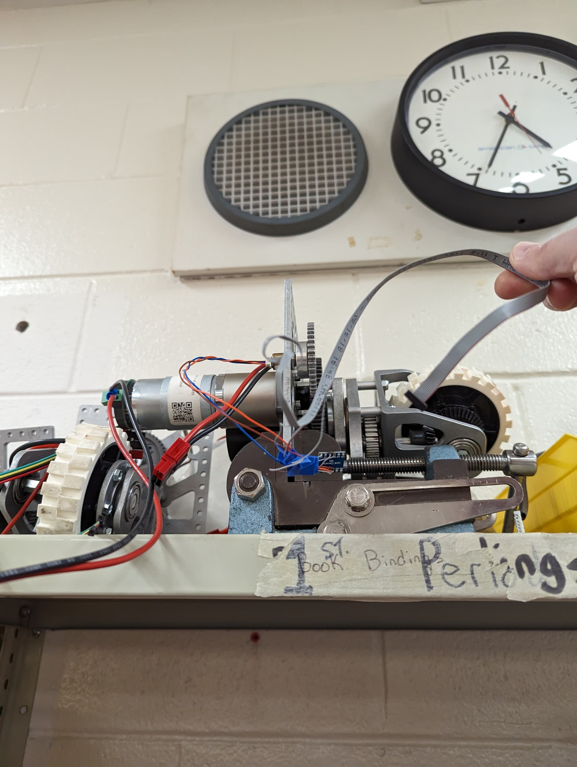

FYI Team204 is also going ahead with swerve and steers. We may take a different approach than full swerve though. We replaced the CIM motors with NEOs but kept the others. The turn motor is connected to a TalonSRX that is configured with position control. The encoder on the back of the turn motors are not used. Instead we have an MA3 absolute rotary position sensor geared to the turn output with a 5V-3.3V level shifter connected to the analog input of the TalonSRX. We only have two MA3s hanging around so we are also investigating an AS5600 based solution.
A few more notes. Team204 has never functioned with swerve and steer before this year. Another team told a mentor that they were prone to breakdown. This is my first year with the team so I am getting this second hand. Upon inspection, I found a few flaws that we hope to correct before competition. The most glaring is an improperly sized thrust bearing between the upper and lower assemblies. They are off by half a millimeter on one. The latest CAD shows the correctly sized needle bearing parts from McMaster but we have bronze and steel washers that came with ours. There are a couple of other rigidity concerns but that is the big one. The other thing is a concern for all of the swerve drives, lack of cowling. We can compare notes on both hardware and software if you’re interested.

I tried to capture the current wiring. We are dealing with sensor values from talonsrx that seem wrong. The raw values look fine so I think it is just a wrapping configuration that we have wrong.
Thank you for showing me this! My colleague said “No one is using Talon’s for Swerve” AND HE WAS WRONG!! I do have to add onto my library now to support you though.
