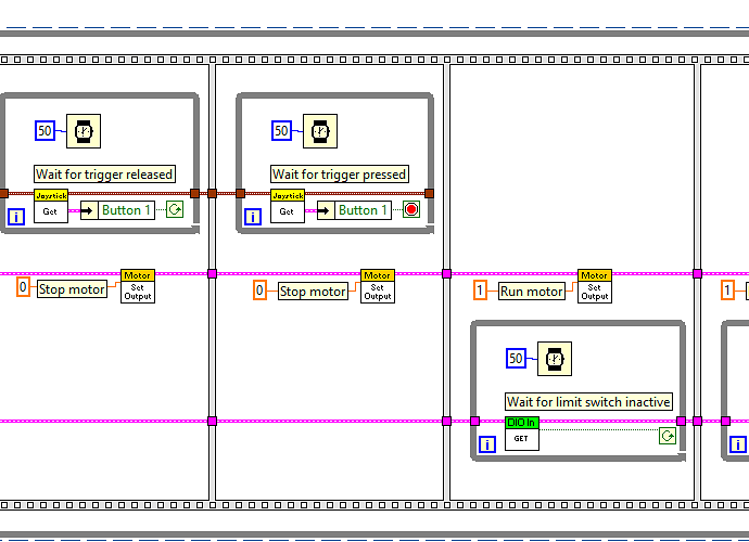

So we are looking at a wheel that rotates and then hits a switch and stopping. Then a button or trigger is pressed and activates the motor to rotate one revolution to the switch and stopped by the switch. Thus the mechanism is loaded for the next shot. %between%
asking a question on how should I program that and maybe some pics of what teleop would look like. I want the motor to keep rotating until it hits the switch and then stop, a trigger on the controller would activate the cycle again so the motor goes around until it hits the switch again.

That’s going to involve something a little more complicated than simple combinatorial logic. I suggest implementing it as a flat sequence in Periodic Tasks.
In the first frame, halt the motor and wait for the trigger to be released. In the second frame, halt the motor and wait for the trigger to be pressed. In the third, set the motor to whatever value you want it to run at and wait for the limit switch to be activated. Put the entire sequence in a neverending while loop so it starts over every time it finishes.
The “wait for” parts can be programmed as while loops that terminate when the condition is seen. Make sure to put a delay inside each of those loops so they don’t monopolize the cRIO’s CPU.

I attached a VI snippet of the sort of thing I was talking about. It goes in Periodic Tasks as its own loop, not inside anything else.
It will not work in its current form. Both of the limit switch while loops are configured to continue while the switch value is true. Depending on whether the switch is normally open or normally closed, one or the other of the loops needs to be changed to terminate when the switch value is true instead.
You will also need to use the appropriate Refnum names on the left side, and set the motor output to the proper value to make it run in the direction and at the speed you want.

So I went to go try the program and the limit switch is not working. I tried switching the continuous to stop, and stop to continuous switching the two around. No luck getting it to work

Is your limit switch physically and electrically working? Use Test mode to monitor its value on the Dashboard and make sure it changes when you activate the switch.
I’ve contacted ni and they came up with something different
What they suggested is basically what I would have suggested before you answered my first question. That code doesn’t have any provision for stopping the motor if the control is held continuously, and you said you wanted to force the trigger to be released and pressed again in order to command another revolution.
