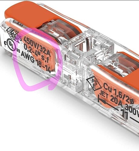

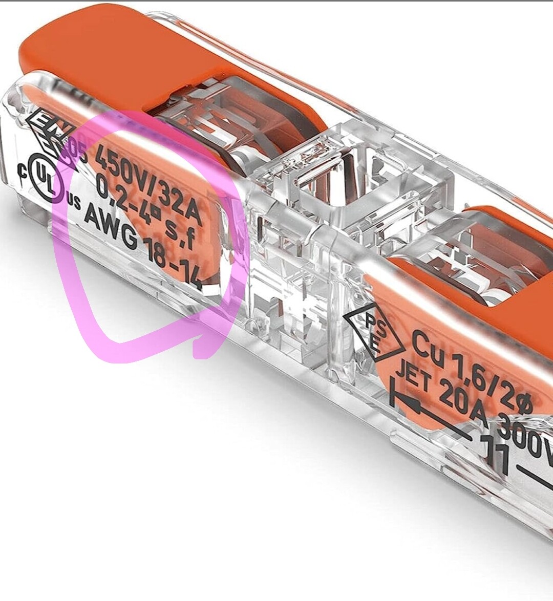

Do not use the inline version of Wago’s for CAN. Use the side byside version. The inline version are only rated down to 18awg wire and typically CAN is 22 awg
Actually, what we use are the CAN Bus Inline Wire Lever Nuts (WCP-0486) from WCP, which are specifically made for CAN connections and 22AWG CAN wire (they’re even color coded, just to keep the newbies straight on which wire goes where.) They work perfectly and the inline nature is definitely something we prefer for streamlining the CAN connections.

I’ve done this before successfully. I would not recommend it. 22AWG CAN wire is smaller than the 20AWG max that Anderson recommends, so if you don’t double-crimp or solder the wire into the crimp, it’ll come out. Frankly I just don’t think it’s worth the hassle when 412 lever nuts work so well. I haven’t tried the 2401 on CAN.
When REV started stocking these, they made a video comparing WAGO 221-2401 (the inline one in your pic) to 40A power poles.
If you want to stay within ratings, you need to use the 221-612 for 10AWG 40A and 221-412 for
22AWG CAN. That said, it’s fine to experiment with different things you can get away with, just make sure that you thoroughly tug test your connections no matter what solution you use. I can’t remember if REVs product page is good enough to make the 2401 legal but I did see them on robots this year pushing 40A.
Also PSA: WAGO is a connector company! Not a single connector! When you say “we use WAGO” that’s worse than useless because the 3 major lever nuts that people use are all fairly different, and it’s impossible to tell which ones you are referring to. 221-2401 is the inline lever nut for large wires. 221-412 is a 12-24AWG lever nut rated for 32A (like the inline one). 221-612 is a larger version of the 412 rated for 10AWG and 41A. 41x or 61x has x taps in case you want to branch out a custom circuit.
