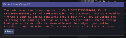

The struggle is still very real with 2023.4.1. Tonight I characterized our swerve drive and ran into several problems:
  • Our first run of tests were successful, but the analysis gave us an error:
  • Multiple times we ran into the issue where SysID said the robot reported the wrong project type. Closing and re-opening SysID worked around this, but I ran into it >5 times before I was finished.
  • One time everything was right but the robot just didn’t move. I stopped the test and the popup said the robot reported moving 0 meters.
  • Loading a project that has a Motor CANivore Name value does not repopulate the value. I had entered “swerve”, but loading the config populates the field with “rio”. This wasn’t a big deal once I figured it out, but I had to re-enter it every time after closing a re-opening SysID to work around the “wrong project type” bug. It took a good 30-minutes to crack the first time. I’ll open a bug for this because it’s reproducible.
  • After a few runs, we finally got the analysis error to go away by changing the Samples Per Average and Time Measurement Window. We increased the Samples Per Average to 8 (the tooltip recommends a value between 5-10, and the only option between 5-10 and 8 :thinking: We set the Time Measurement Window to 5.

I’d have to see the analysis JSONs before and after to diagnose this.
