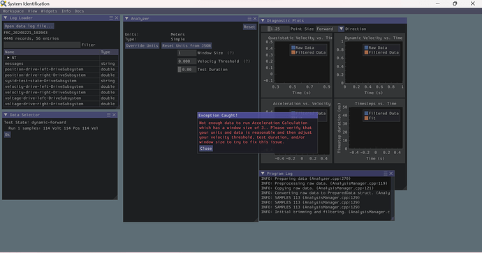

Sysid Can't run acceleration calculation

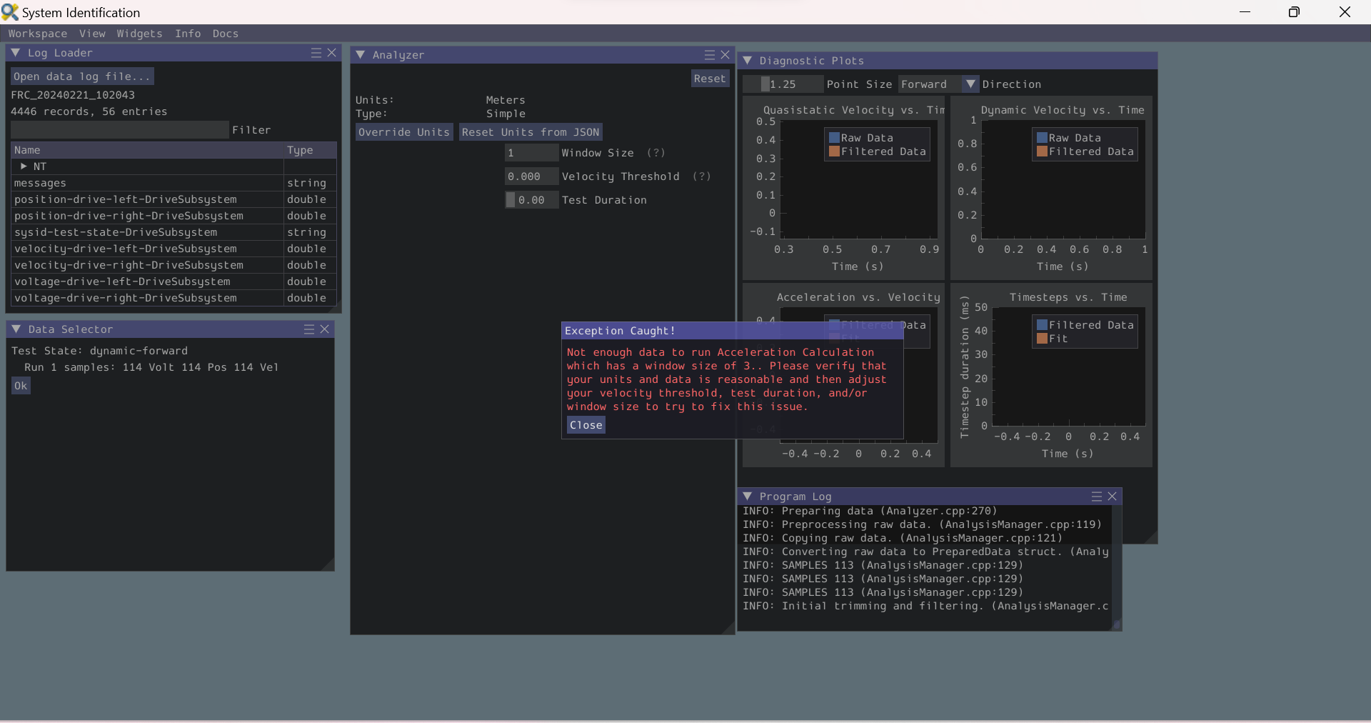

We are trying to run sysid for our drivetrain but after we fill up the data selector section and press Load, we get this error message:
The units are ok, we tried adjusting all of the variables and rerunning the tests, but nothing is working so far.
has anyone suffered from this and know how to fix it?
Can you load the log file into Advantage Scope and show us the units on a graph?
