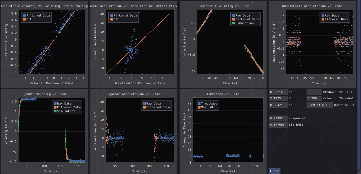

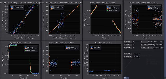

Hey! With the inclusion of the new SysId tool in this year’s WPILib, I figured I’d start a thread for data sharing so people could get a sense of what characterization values ought to be for various types of mechanisms.
In an attempt to standardize what teams share, please include:
  • A screenshot of the “combined diagnostics” page:
  • A description of your mechanism (including, crucially, motors and mass).

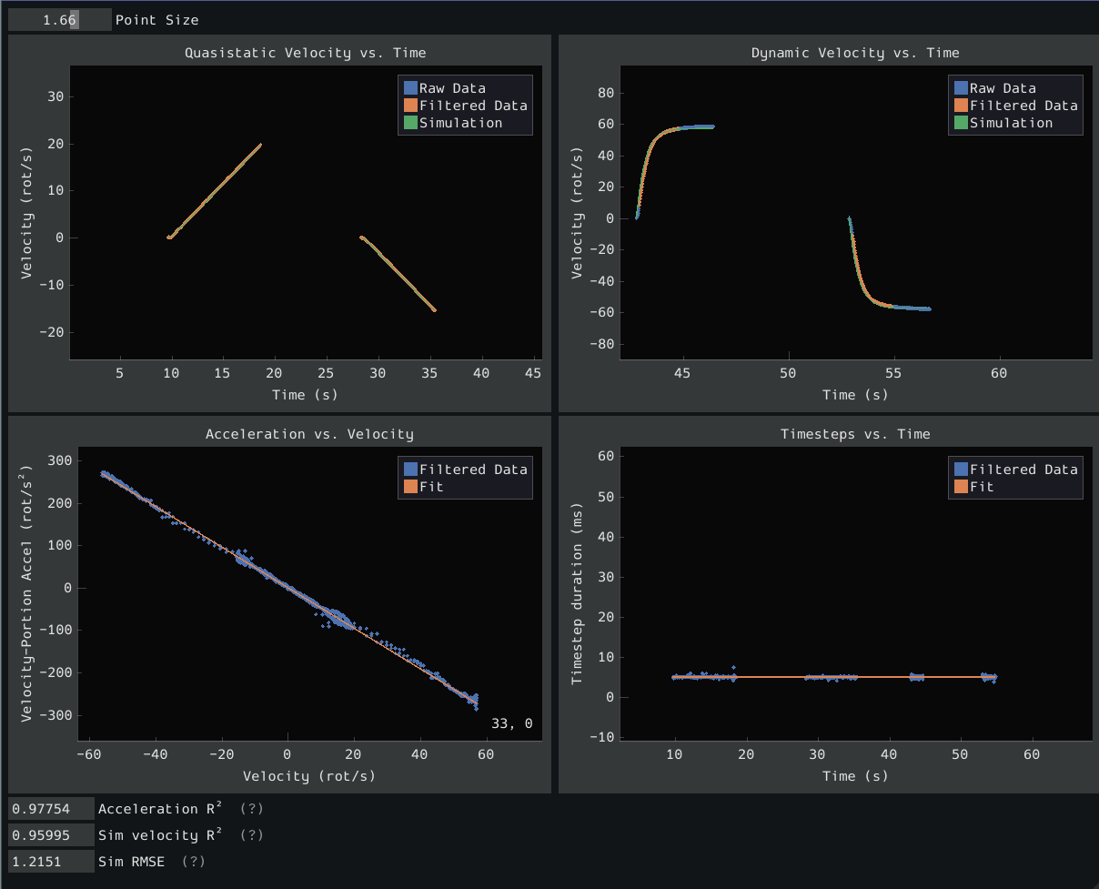

Swerve Turning
SDS MK3 swerve module, 1 Falcon 500. Geared 12.8:1. I may recharacterize this with a lower dynamic step voltage in an attempt to get more timestamps, but it’s good enough and works.
Gains
We ended up using the onboard pid and kF for a faster response time. Below are the sysID-calculated gains:
  • kS: 0.60572
  • kV: 0.20717
  • kA: 0.0068542
Gains we actually used (in CTRE units, described above)
  • kF (basically kV in different units): 0.049
  • kP: 0.1
  • kD: 0.02

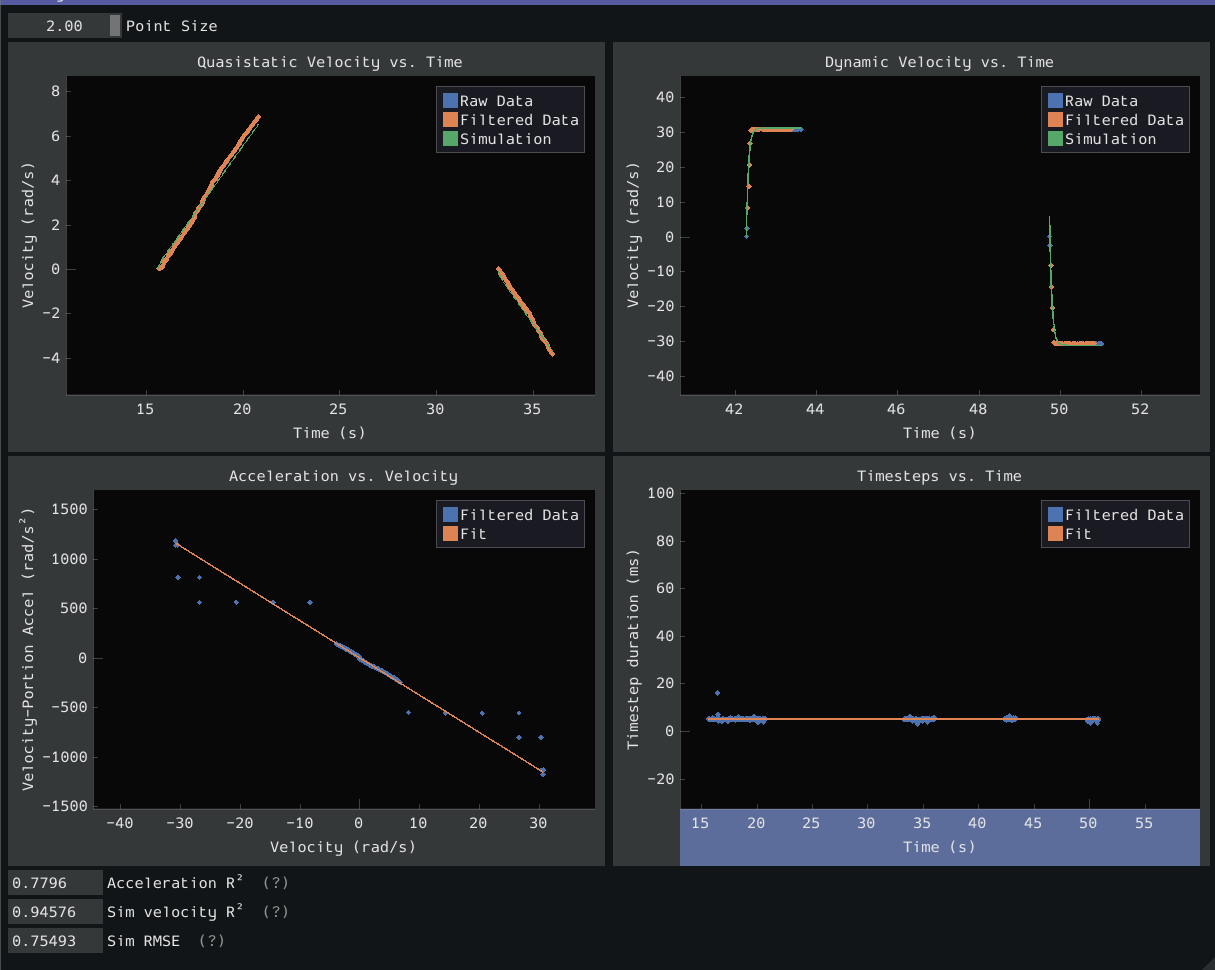

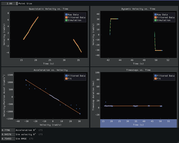

Shooter
Falcon 500 attached to 2 6 in Colson wheels on a hex shaft (no flywheels). No reduction, 2.61 pounds.
Gains
  • kS: 0.65884
  • kV: 0.11065
  • kA: 0.023167
The feedforward output is scaled back by 0.95 to enable bang-bang feedback control!

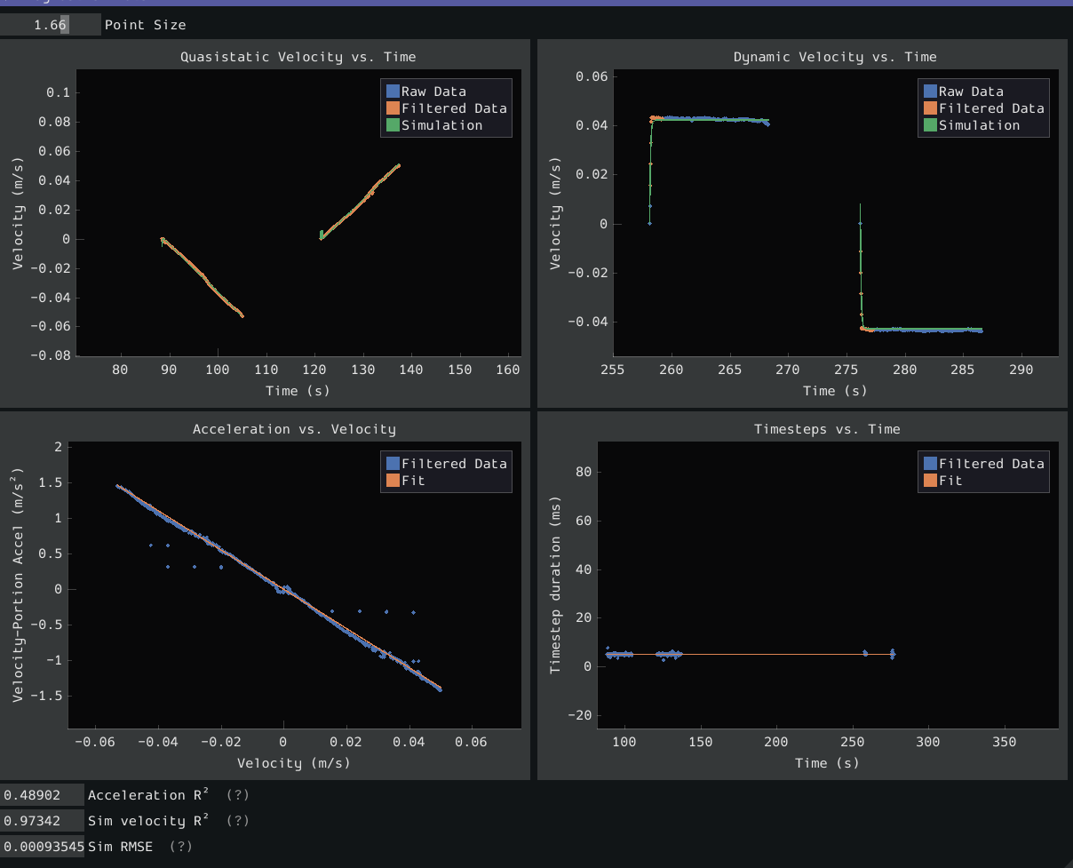

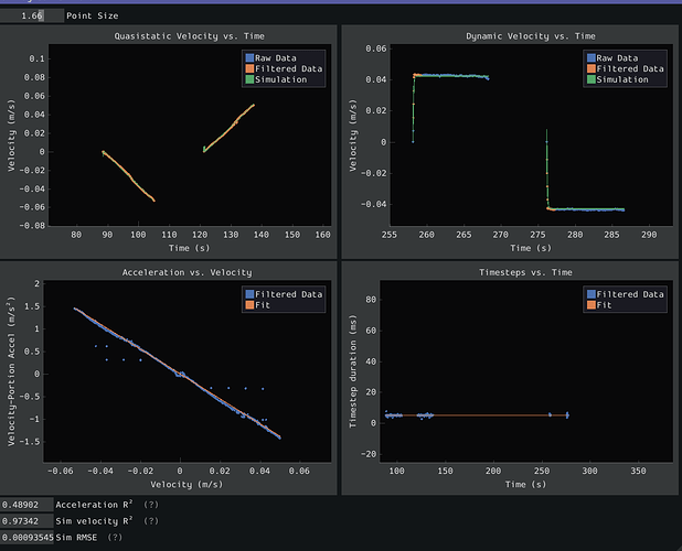

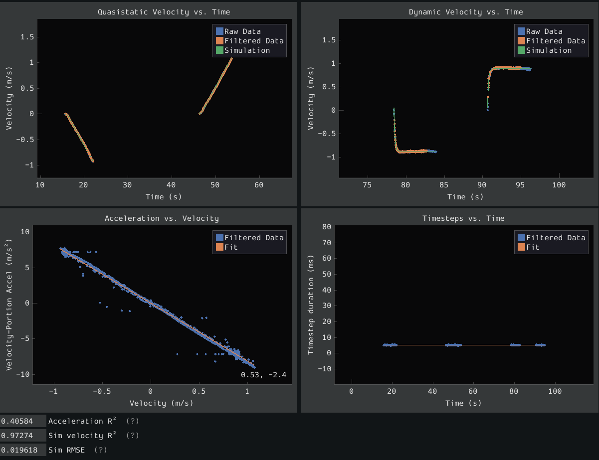

Climb Elevator
Falcon 500 geared 37.67:1 over chain to an about 3 lb elevator. When loaded, about a 70 pound robot as characterized (will change).
Feedforward Gains (unloaded)
  • kS: 0.70015
  • kG: -0.010378
  • kV: 30.626
  • kA: 1.1098
Feedforward Gains (loaded)
  • kS: 0.44256
  • kG: -0.505 (this was tuned to be make steady-state stabler than with the provided gain of about 0.4).
  • kV: 32.238
  • kA: 14.427
Feedback Gains
Added. :+1:
