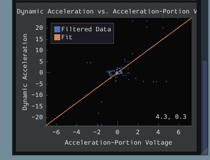

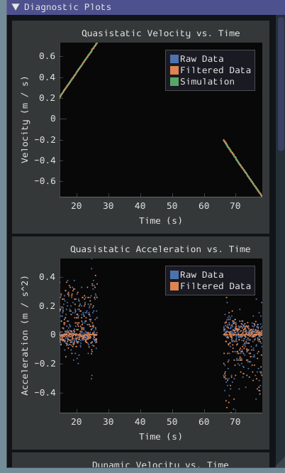

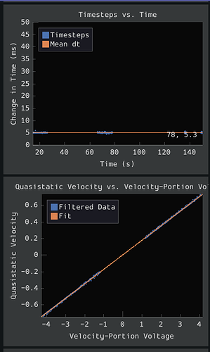

Hey guys, my team is doing characterization using SysId, and our results are showing quite noisy acceleration values which we feel like could be messing our Ka constant. Even though our acceleration graphs look noisy, our velocity graphs look quite accurate. Does anyone know what we could do to possibly fix this? Attached below are our analyzation constants, and graphs.

The acceleration plots are always going to be noisy, because acceleration is an extremely noisy variable. Look at your sim R^2 and RMSE figures.
The plots you have look pretty normal; the big “clump” in the middle is all noise from the quasistatic test.
Ok, thank you. Our R squared is 0.99991, and our RSME is 0.044899 which both seem good. Do you know of any other factors that could affect the acceleration of the robot?
Gearbox/transmission friction and wheel-to-ground interactions are both quite noisy, even if their time averages are well-approximated by simple functions.
If you want to see a relatively “clean” acceleration plot, use the characterizer on an underpowered mechanism with a lot of inertia. That’ll lengthen the characteristic timescales of the system response so that the acceleration from the driving signal is more easily distinguished from the noise.
In either case, the green line in the position plots shows the path of a simulated ideal motor with the determined coefficients. If that fits your data well, that is generally what matters.
