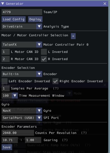

Has anyone else seen had issues with Robot Code after deploying from SysId?
I generate the Drivetrain Profile using the two CAN addresses and the TalonFX’s. I show the encoders as “Built-In”… I include the Nav-X gyro, the encoder counts per revolution and the gearing…
I’m able to deploy successfully, but the Robot Code is not stable, and I cannot connect with the client to start the tests.
I verified that I could deploy when using a “General Mechanism” using a TalonSRX controller and was able to connect.
Any thoughts? Thanks! :slight_smile:
SysID Generator
Is SysId updated. We had to reinstall it from the ISO, selected tools only, after we updated wpilib.
Our issue was after deploy client couldn’t connect/couldn’t select tests.
Can you check what version of the SysID tool you are running? (There should be a version/about section to open for that) We encountered a similar issue a month or so ago, but it was resolved by using the newest available version at the time. There was a new WPILib release about a week ago which includes some SysID changes, so it probably wouldn’t hurt to run the newest installer for it. (https://github.com/wpilibsuite/allwpilib/releases/tag/v2022.4.1)
Version v2022.3.1 Will definitely do the upgrade… Thanks! :slight_smile:
Thanks! Will give that a shot… We are running 2022.3.1 and looks like there was a recent upgrade. :slight_smile:
