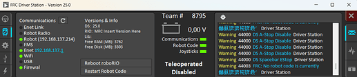

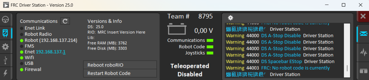

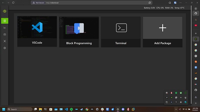

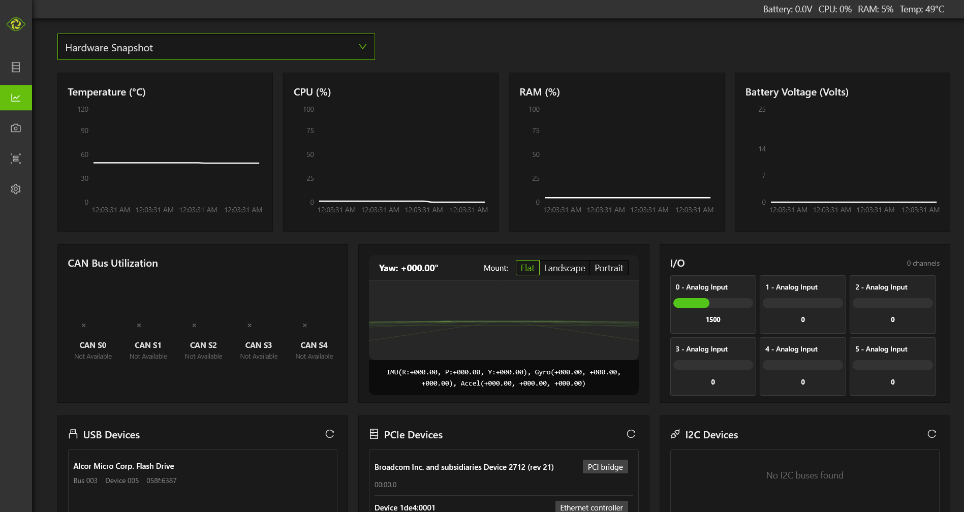

I flashed a Pi 5 with the Systemcore Alpha 3 image just to test. Driver Station is able to connect, and robot.local is reachable, but as expected, it doesn’t fully work. Although WPILib is able to successfully deploy the robot code, the Driver Station reports no robot code.
Edit: Got it to deploy the code with a virtual can simulator.

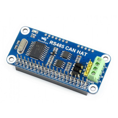

I am trying to communicate with an MCP2515 connected to an Arduino using an MCP2515 connected to a Raspberry Pi, to test if SPI-CAN communication is doable. At 500 kbps, messages are delivered both ways without any issues, but when I go above that speed, it starts causing problems.
I’m currently using bit banging because I couldn’t get the Python spidev library installed, and the MOSI-MISO loopback test failed as well. I’m guessing the loopback failure might be because the GPIO setup was originally made for the CM5.
I’m not an expert in this area and I have no idea what I am doing, so any guidance would be much appreciated.
Also, sorry — I meant to reply to my own message but accidentally replied to truher instead.
This is on the Raspberry Pi side? You should use the mcp2515 kernel driver and socketcan instead. On a Raspberry Pi you can enable this by applying one of the device tree overlays for use with the mcp2515.
I’ll note that even using that driver, it may struggle to reliably receive all messages at high bitrates on a bus with high utilization- this is due to the fact that the mcp2515 can only hold 2 received messages at a time, and if the host processor (the pi, in this case) hasn’t read the message before more messages arrive, the incoming messages will be dropped. The pi receives an interrupt request every time a message is received, but most of the interrupt routine implemented in the Linux driver is executed in a threaded (non-hard IRQ) context, so depending on system configuration and load, it can still be overwhelmed. These are really designed to be used with a bare metal microcontroller that can service interrupts quickly.

Thank you, yes it is on the raspberry side. I edited the Systemcore boot config to enable spi and I can see that MCP2515 was initialized after reboot but clock reports as 4MHz. Also “sudo ip link set can0 type can bitrate 1000000” returns invalid argument. “sudo ip link set can0 type can bitrate 500000” sets the bitrate to 500kbps successfully but I believe I need 1Mbit/s for FRC CAN communication.
I actually bought that 2-channel CanFD Hat, but it won’t arrive for another week . I got a few 2515s someone gave me so I am just trying to get them working.

I’d recommend not doing this with the systemcore image, at least while you’re trying to get it working. If you must, I’d recommend disabling the systemcore CAN interface overlays.
You’re currently telling the driver that the controller is using an 8MHz external oscillator. Is this what you actually have attached? If it’s not, you’ll need to set the correct frequency in the overlay configuration in config.txt.
Linux won’t let you set the bitrate to 1Mbps because that bitrate isn’t achievable with the MCP2515 using an 8Mhz oscillator. On the MCP2515, 1 time quanta is 2 cycles of the external oscillator (which is why the clock is reported as 4Mhz). To achieve 1Mbps reliably on this chip you’ll need an oscillator with a frequency of at least 16MHz.

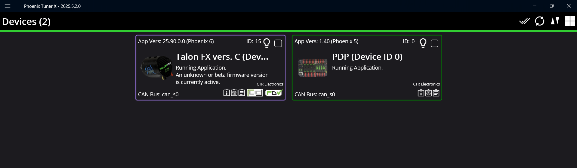

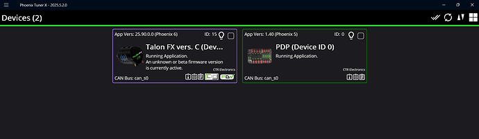

I got the can_s0 and can_s1 working on the PI 5 with 2-ch CAN FD hat, Ryan_Blue mentioned. I haven’t been able to get Tuner or the Java code to control any motor controllers, but they do show up in Phoenix Tuner, and I was able to update the firmware on the Kraken

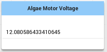

I can fetch motor voltage, but the code still can’t control the Spark MAX controllers either.
