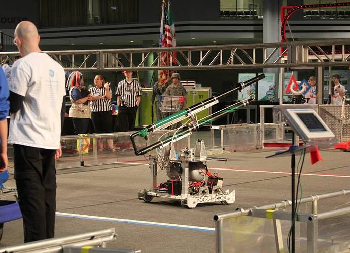

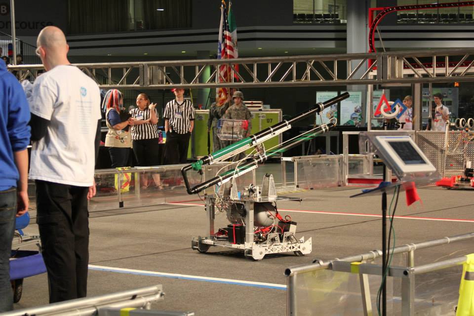

Ours is much smaller in length than the post above (that robot failed inspection I am sure :P)
It is about 4.5’ long, and is shoulder fired. It looks very much like a bazooka and very much so, as it is one. I don’t actually know how far horizontally far we can fire, but we can fire t-shirts over the top of this stadium (we hit the bottom press box window once) from the track at the bottom
