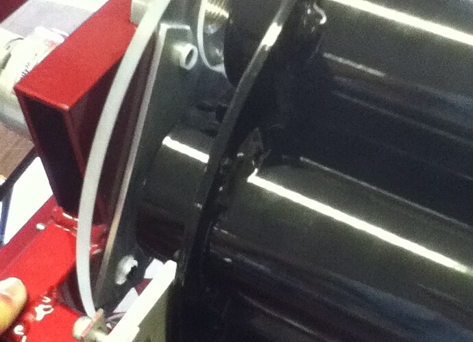

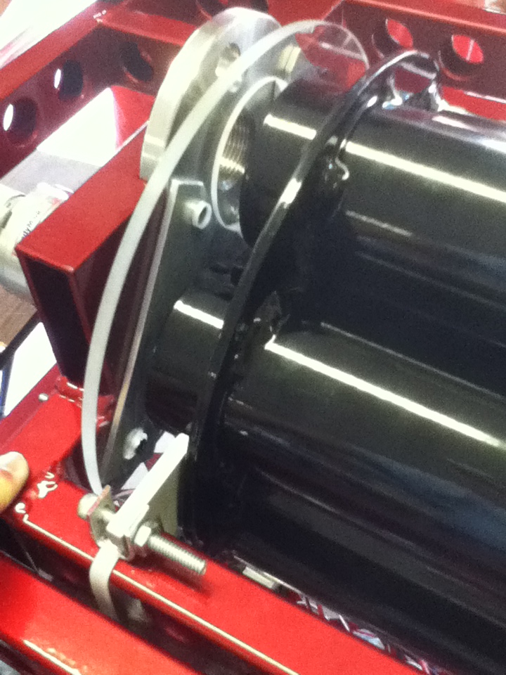

our team is trying to make a t-shirt cannon with a revolving barrel. does anyone know how to seal the barrel each time the barrel rotates?
No need, at least in our experience. There is some air loss but the plate that backs the barrels is a close enough fit that it’s not a big pressure drop.

We have a gap of about half an inch (yes I know it’s quite a bit) between the exhaust valve and the barrel but the maximum range is still about 200 feet.
GRT808 Can you post some pictures.
Our revolver has been upgraded with a scuba tank as well. We have the scuba regulator fixed at 120 psi and have a second regulator (standard FRC regulator) that adjusts pressure into the accumulator tank at no more than 60 psi and we have a third regulator that adjusts pressure into a small accumulator tank that operates the modified 3/4 in gate valve we use to fire the contraption.
Our revolver seals are spring loaded pvc on both sides of the revolver cylinder and only open up about 1/8 inch when firing. We get about, never measured it but probably about 100 ft at max elevation. We do have 10 shots though and the accumulator tank refills in less time than it takes to rotate another shot into place.

Found it! Sorry it took so long. In the picture it looks a bit bad…but it works. Check it out on youtube sometime. (and in our chairman’s video)
