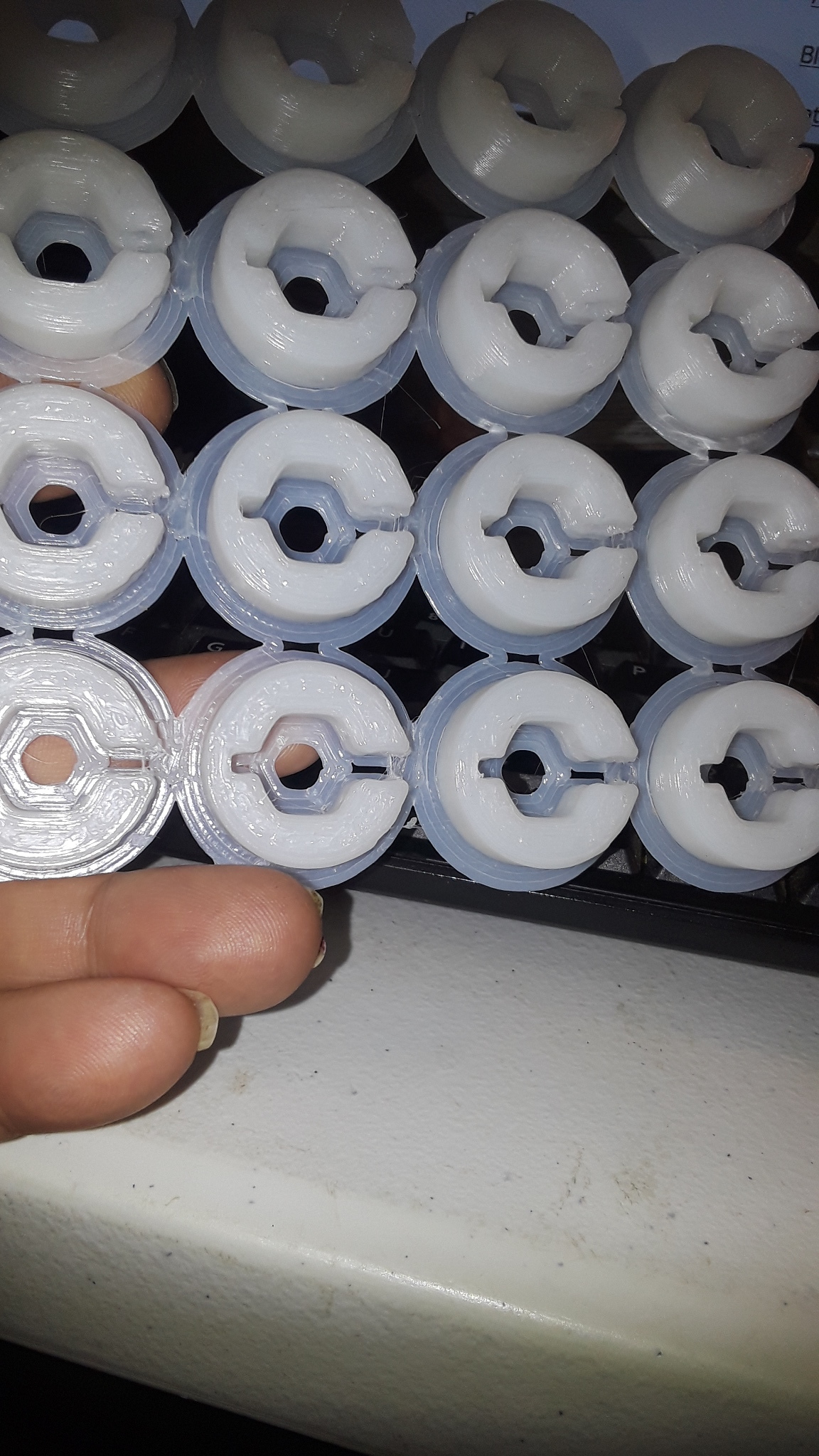

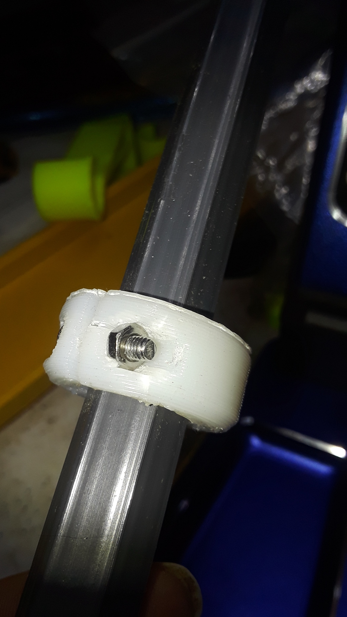

And to keep the weight down - and save $$ we are using 3DP collars
All files you see on grabcad here is a direct link to the Rack and Pinion which also has the collars
For now everything is printed in HIPS and its at this time about 90% on the CHIRON with a .8 nozzle. If you download it be aware its work in progress so files can and are changing. So for example on the racks we increased the backlash by .06mm which made them run smoother with the way our printer is tuned in on HIPS as we have a little more overprint than we initially thought.
