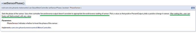

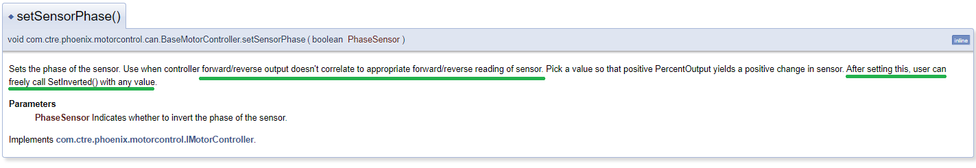

@ozrien it would be nice if the API documentation for the TalonFX mentioned that .setSensorPhase() did nothing. Better yet, make that method throw an error.
I have yet to find where in the CTRE documentation that this is documented. I’ve only seen it noted on here on ChiefDelphi, and only after I narrowed the problem down to the setSensorPhase call was I able to search for the correct term on CD.

I disagree because calling the routine isn’t necessarily an error condition.
It is harmless.

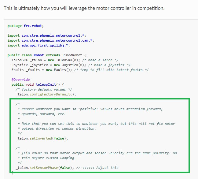

This has nothing to due with sensor phase. Sensor phase is the relationship between the selected sensor’s direction and motor output. In the FX, the selected sensor (when integ is selected) is always in phase.
The test procedure is to select sensor phase, then drive positive motor output and confirm positive selected sensor velocity. This is what we document. This is what our examples reference. This has not changed. If you do this in FX, then you will find the test passes regardless of what bool you pass because we ensure they are in phase.
I suspect you didn’t setup your motor inverts correctly, meaning you want positive sensor velocity when the robot moves forward. Sensor phase has never been used to solve this situation. Use SetInverted to make positive-motor-output (and sensor velocity) occur when your mechanism moves forward/upwards.

Note that sensor phase only ensure sensor and motor output match (which they always do on FX). Then you call SetInverted to decide what direction you want positive sensor/motor-output to be.

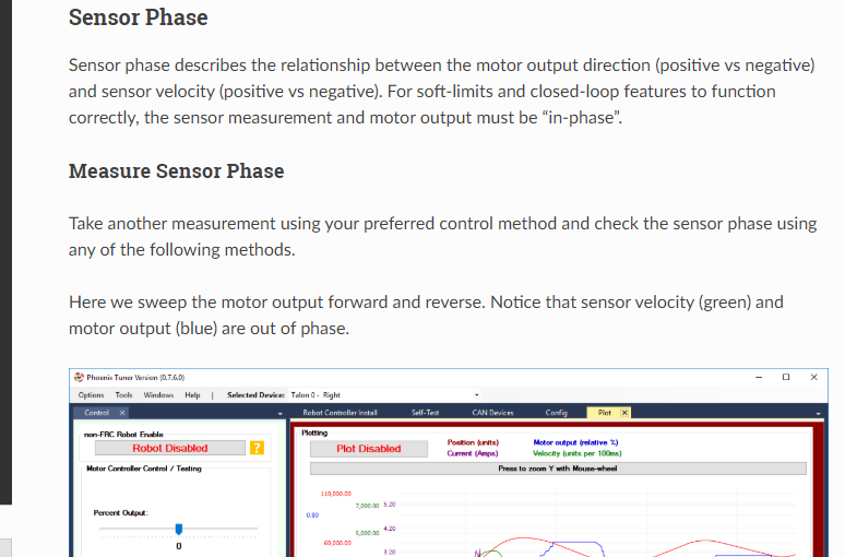

Test procedure below for how to align the motor and sensor phase. Again if this procedure was followed, it would passed.

But I think some users treat “sensor phase” as “sensor direction”, which would be just arbitrarily flipping the sensor output. Remember there are 3 properties to track
  1. moving the robot forward/reverse
  2. motor output positive or negative
  3. sensor positive or negative
Sensor phase only addressed 2 ↔ 3.
SetInverted addresses 1 <->[2,3].
Also note on all CTRE MCs, changing the SetInverted() input does not require changing setSensorPhase(). That’s the difference between sensor phase and sensor direction.
