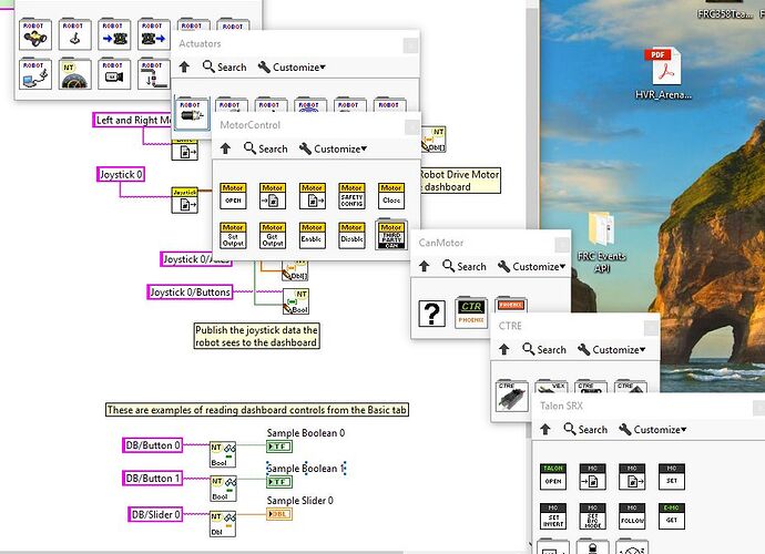

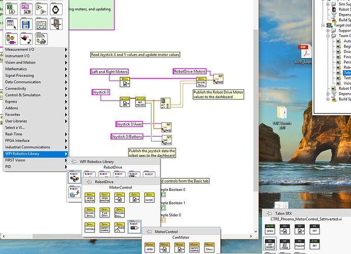

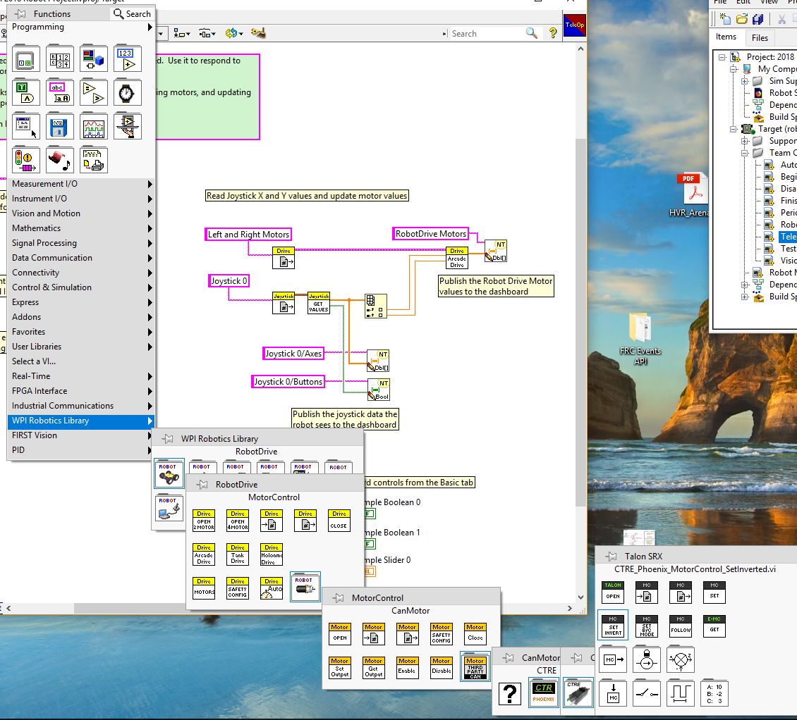

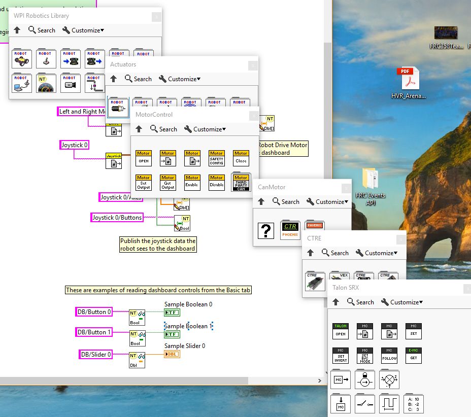

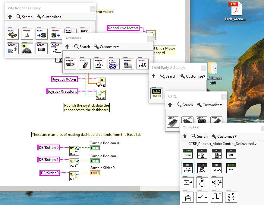

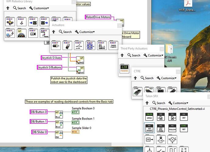

Can someone point me to which VI contains the invert feature here? It isn’t really clear to my programmers where to look. This seems to be much harder than it needs to be.
Here’s where the menus lead to Set Invert…
There are actually several different paths you can take through the menus to get to the Talon SRX/Victor SPX specific menus. The first is found through RobotDrive, the second and third attachments are found through the Actuators.
Ignore the links with oversized question mark. Those look like old deadends that weren’t cleared out.
The third party palette in the main WPILib palette works fine for me.
