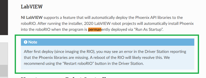

Make sure you permanent-deploy (build then run-as-startup). Then restart the RIO. Only need to do this once.
That worked! (Sorry for the late reply)
