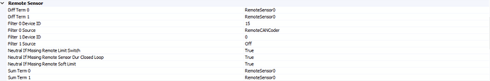

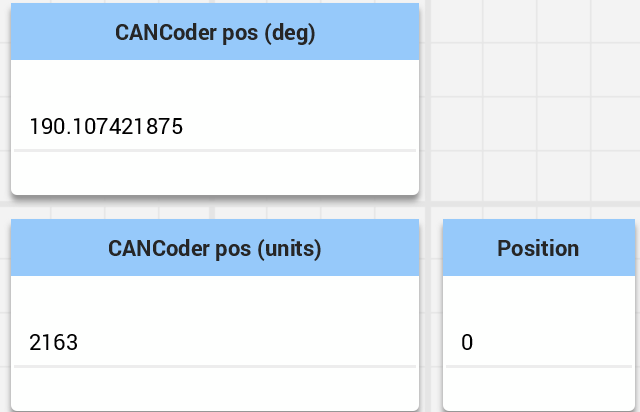

I am attempting to use a CANCoder as a remote sensor for a TalonFX and it is not working.
What I have tried:
Using TalonFXConfig:
    TalonFXConfiguration config = new TalonFXConfiguration();
    config.sum0Term = FeedbackDevice.RemoteSensor0;
    config.diff0Term = FeedbackDevice.RemoteSensor0;
    config.remoteFilter0.remoteSensorSource = RemoteSensorSource.CANCoder;
    config.remoteFilter0.remoteSensorDeviceID = cancoder.getDeviceID();
    config.primaryPID.selectedFeedbackSensor = FeedbackDevice.RemoteSensor0;
    // periodic
    SmartDashboard.putNumber("Position", getPos());
    SmartDashboard.putNumber("CANCoder pos (deg)", cancoder.getAbsolutePosition());
    SmartDashboard.putNumber("CANCoder pos (units)", cancoder.getAbsolutePosition() * DEGREES_TO_MOTOR_POS);
Using Phoenix Tuner:
It still does not read the value for the sensor and returns 0 using motor.getSelectedSensorPosition()

Some things to double check:
  • Is your Talon FX firmware up-to-date? (current v5 latest is 22.1.1.0)
  • Is your CANcoder firmware up-to-date? (current v5 latest is 22.0.1.2)
    [Note latest firmware version list is here]
  • Is your CANcoder on the same CAN bus as the Talon FX? If one is on the RIO and the other is on a CANivore or vice-versa, the remote sensor features won’t be able to work.
What is the getPos() function you’re using in the SmartDashboard put? Just to simplify the path of data I would recommend replacing that with talonName.getSelectedSensorPosition().
Also, do a self-test snapshot of the TalonFX in Phoenix Tuner. What does the self-test say the selected sensor position is? If it matches what you expect from CANcoder that means the config setup & hardware is correct and it’s a code-side issue; if the value is always zero like in your smartdash reporting then it’s either a config or CAN bus issue.
  • Will check firmware/do self-test snapshot later today at our meeting
  • Both the CANcoder and the motor are on the same CAN bus (“Canivore 1”)
  • getPos() is as follows:
  public double getPos() {
    return motor.getSelectedSensorPosition();
We are planning to use this and some calculations after the CANcoder works with the Falcon to get the degrees instead of encoder units.
Also, I read that if a CANcoder is a remote sensor for a motor it must have an CAN ID of 15 or less. Is that still a problem or has it been fixed? Current CANcoder ID is 15 and the motor ID is 10.
It was actually any remote sensor CAN ID that was affected - but yes, it’s fixed in firmware.
(Note that linked page has errata/fixes prior to the 2023 season, this season and beyond are in the changelog I linked earlier)
