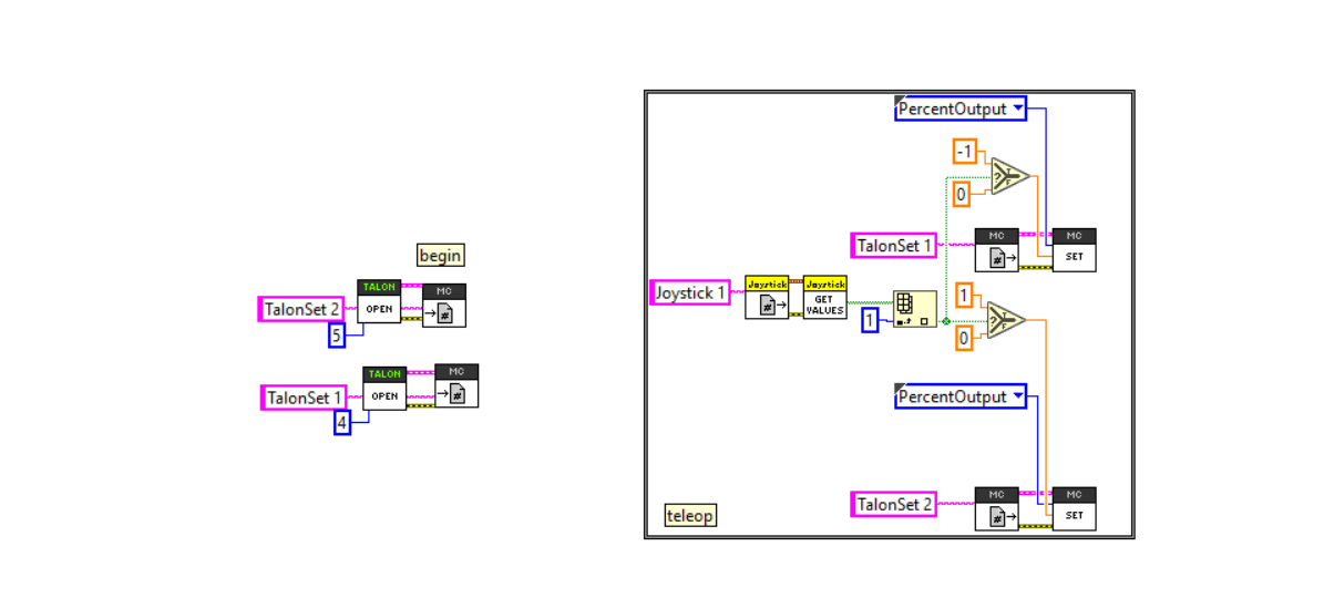

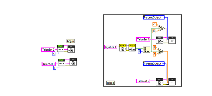

I have been trying to code two Talon SRX motor controllers to run one direction when a button is pressed. However, when I am enabling our robot the Talons blink orange and do not confirm they are receiving code. Am I doing something wrong here? Any help is greatly appreciated!

So I’m not a labview programmer but did you guys initialize your joystick? Not shown in the picture and i’m just trying to make sure.
Not helpful to the question, but instead of manually inverting a motor and running it seperately, you can make the TalonSet 2 follow TalonSet 1 so you only have to set TalonSet 1. You can also make it follow it but in the opposite direction.
Have you tried probing the wires in your code? That is an easy way to verify that the button press command is getting to your selector statements.
I probed the button wires and I get a false result even with my joysticks connected and the button pressed. However, I’m not sure how to fix that. :worried:

You’d probably need to post at least the complete Begin and Teleop vi’s if you want help looking for bugs.
What you showed is fine,
If the talons are still blinking orange, then they are not recognizing the bot as being Enabled (solid orange) - check wiring, check the driver station for erros about CAN IDs - code looks code (assuming you want to press button #2)

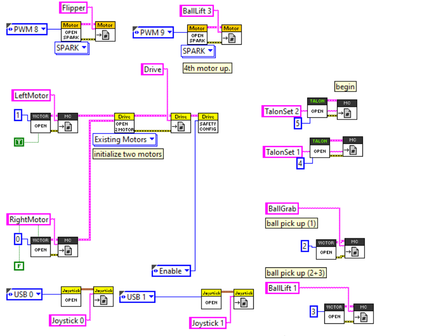

Here is what I have at the moment. I tried to use the same method I used for the Victor SPX controllers, which all work okay.

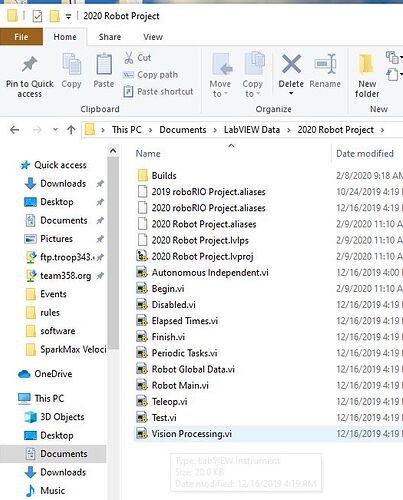

Can you zip the whole project folder for us?
Documents->LabVIEW Data->project
We can run the project to see if we have the same issues.

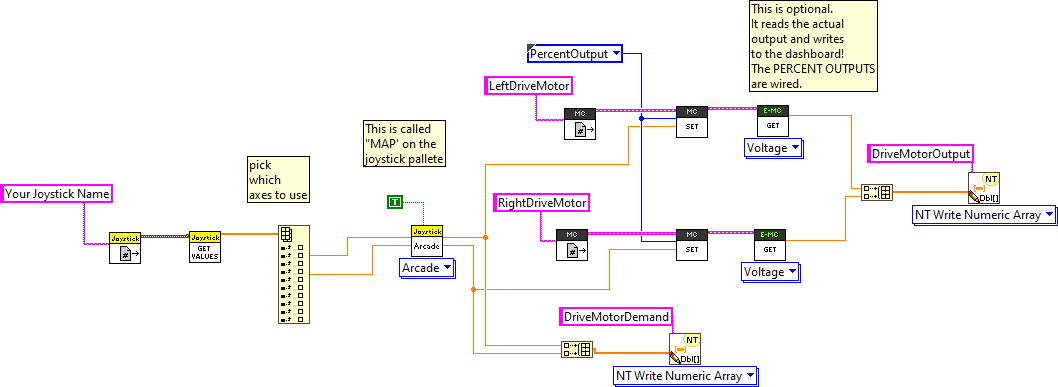

Here is a quick sample drive code (not tested…)
In BEGIN.VI
In Teleop

That’s now a single file, not the whole project folder.
zip this entire folder Documents->LabVIEW Data->robo2020

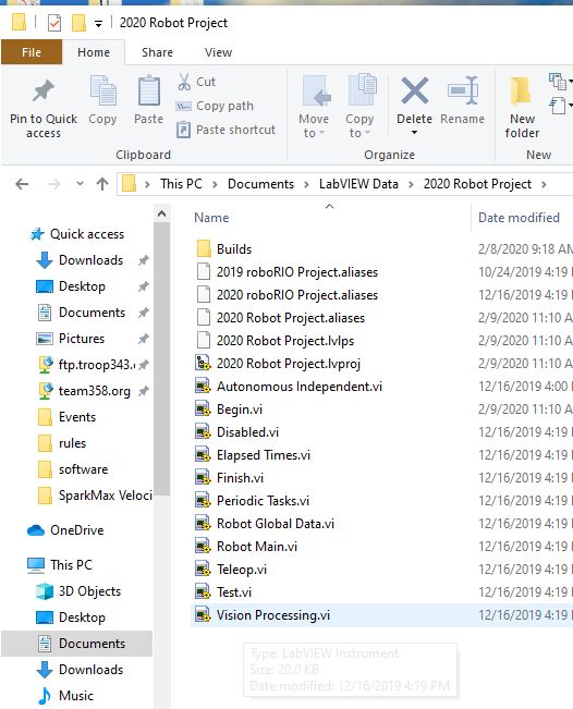

The whole directory of files for a LabVIEW project look like this:
If it doesn’t have these files then there is a different (easier to solve) problem.
The whole master folder will let us test run your project.
