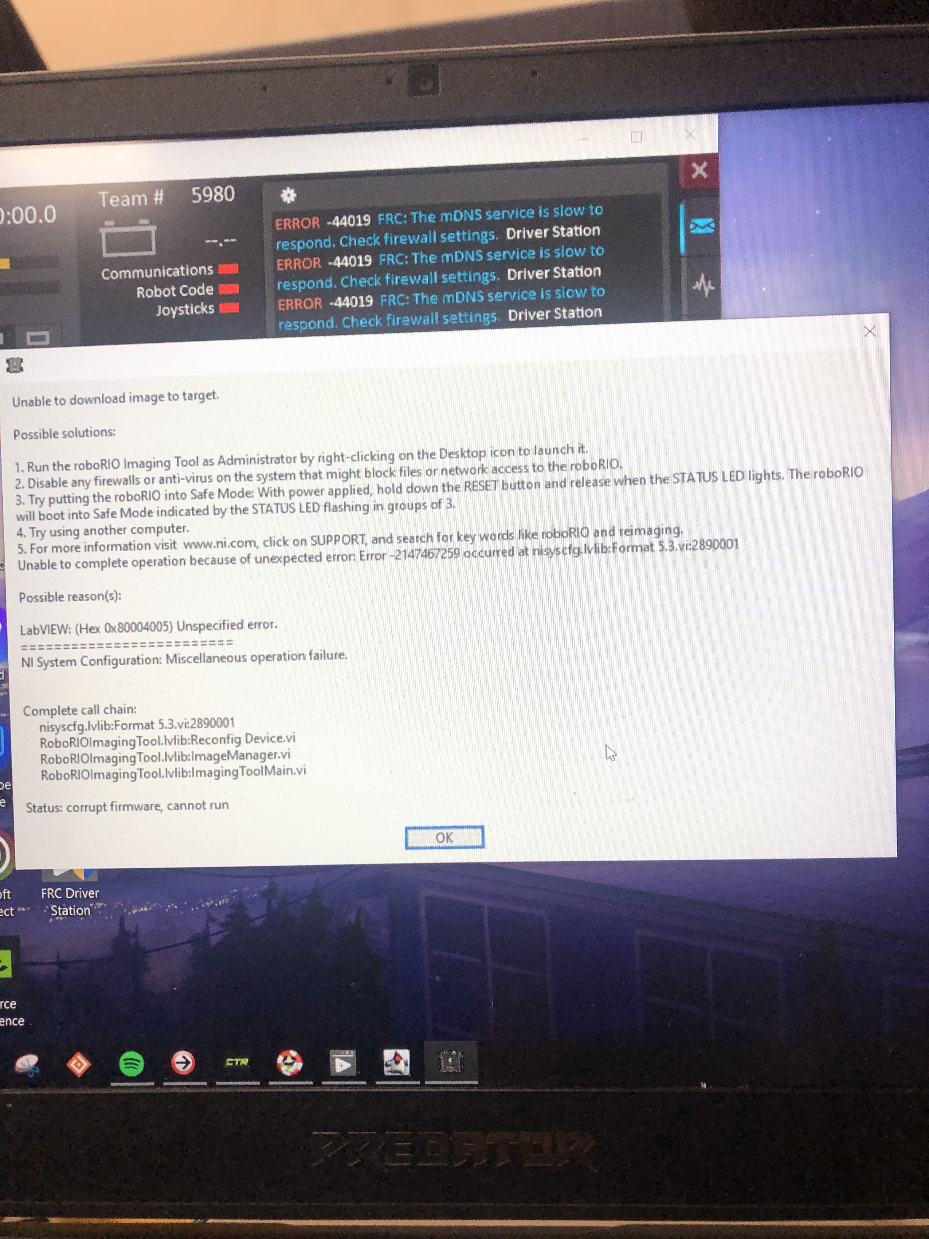

our problem comes with mixing both types of motor controllers. When i take the spark maxes of the line, the talons blink orange like they should, but i have run into another problem.
the talons still won’t show up on any pheonix software, and the roborio is not appearing on the driver station. however, it does show up as an imageable target on the roborio. i am now trying to reset and reformat our rio, but an error always pops up a few seconds after it begins. Has anyone seen this error?
the sparkmaxes and talons not mixing is still a problem, but i am more focused on resetting the rio right now.

our rio was completely shot, i replaced it and everything works perfectly. thanks for all the help!
