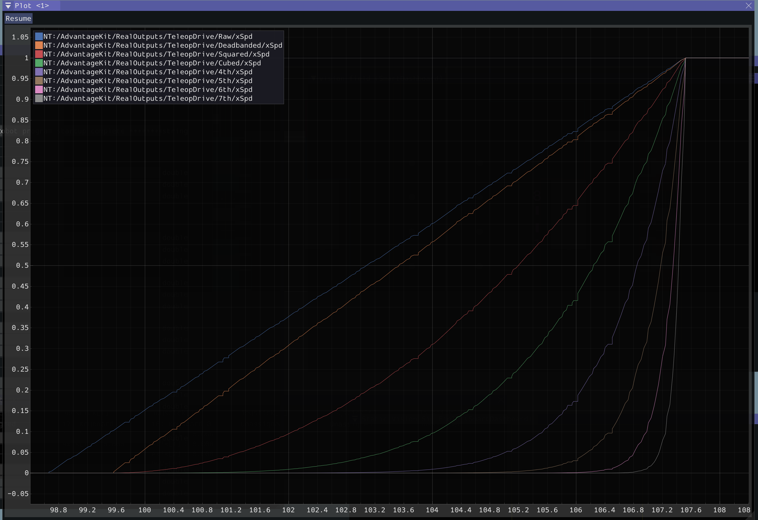

On the topic of controller inputs, one general tip (not tank drive specific) to gain finer control of your robot at slow speeds is to square your controller axes inputs. For instance
var yInput = Math.abs(controller.getLeftY()) * controller.getLeftY();

SlewRateLimiters are also something to look into, not as a replacement for exponential control but in addition to it. Especially if your robot can buck with acceleration.
