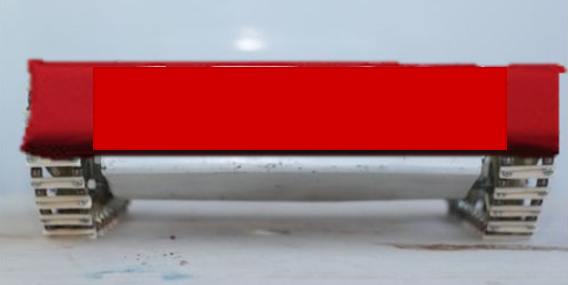

My team and I were thinking about doing tank treads this year so we could get over some of the defenses. We wanted to do something like this. We were wondering, though, about how we would position our bumpers for it to be legal and how exactly that would work. We had a couple ideas like replacing the pvc with rubber and maybe forcing a bike tire around some of our hard wheels as a track, but we are still very unsure of how we would accomplish this.

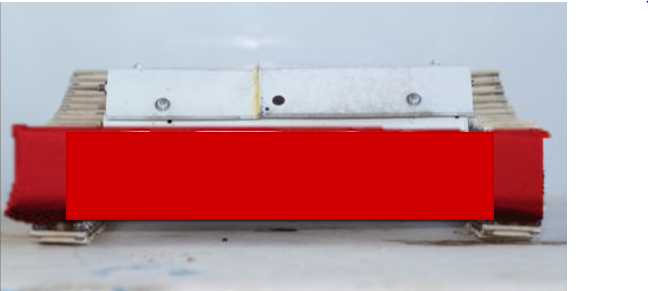

Not drawn to scale or anything. Back bumper would obviously need to be higher off of the ground. Maybe slope the bumpers, maybe don’t slope the bumpers. Just make sure that your bumpers fall within the bumper zone 4"-12". Let me know if the pictures spark something. If you need more idea designs, or with possible bracket ideas, I’ll do my best to help you out as well. Just let me know.

your bumpers must be place on a rigid surface at least on the first 8" of each corner… i guess your frame would have to go around those threads
Not necessarily, you’re mixing two rules together… As long as you have a rigid surface in the same plane as the treads, and your bumpers covered at least 8 inches of each corner, you’d be in compliance. An example would be if the bumper was fastened to 2 L brackets attached to some 80-20.
R19 ROBOTS are required to use BUMPERS to protect all outside corners of the FRAME PERIMETER. For adequate protection, at least 8 in. of BUMPER must be placed on each side of each outside corner…

R21 section G. must attach to the FRAME PERIMETER of the ROBOT with a rigid fastening system to form a tight, robust connection to the main structure/frame
that’s right but your drawings above put the bumpers over the threads. The plywood backing have to start beyond the threads
