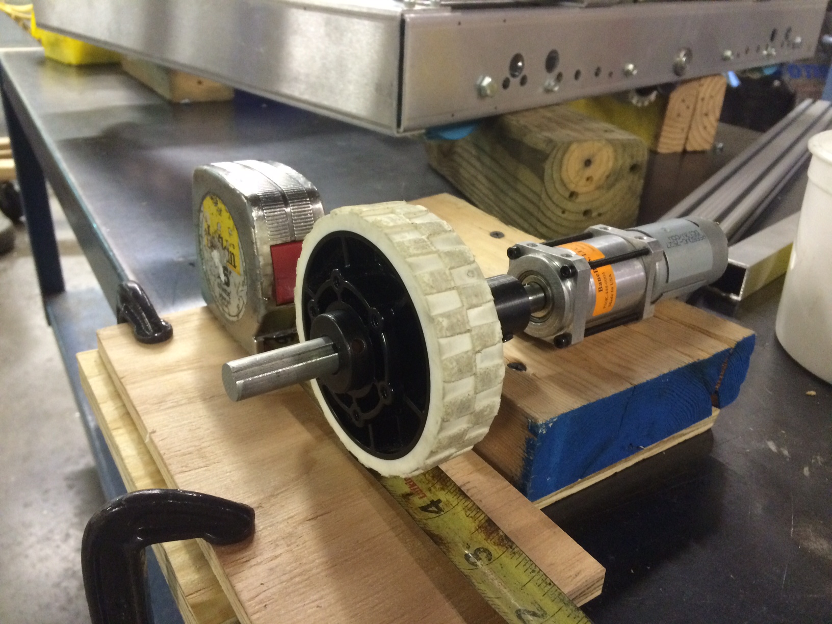

After ruminating on the concept for a few days we finally had a successful proof of concept test. Thank you cjl2625 for the link and another thank you to to Spectrum for creating such a simple solution.

Shown below is a well used AndyMark wheel off of our robot from last year (2014). Running it is a BaneBots motor with a 64:1 gearbox. The tape is an old, tattered item just laying around our shop making it a perfect test candidate. A much rougher setup, but it still works.
We removed it from the stock reel, and made our own.
