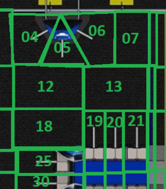

Thanks but I think I did a bad job in describing my request. I was looking for something more like the example below:
Where color intensity is a gradient for the amount of time spent in the zone in relation to the max amount of time spent in a single zone. The idea would be to try and break down the gradient in a way so there is never more than 1 box or zone that is maxed (unless the values are exactly the same)
Ex:
Zone 1 = 5%
Zone 2 = 4%
Zone 3 = 2%
Zone 4 = 5.5%
Zone 11 = 2%
Zone 12 = 4%
all other zones <.5%
Would result in something looking more like:
zoned-field
I know that is WAY easier to do in paint for a small section of a hypothetical field though
Yeah, I think that’s out of scope for me. All the data is there if someone wants to build a tool that does this. I just don’t know off-hand an easy way to interface excel with a viewing tool, and I’d rather focus on other things at the moment. One cautionary note when doing that kind of viewing is that not all zones are the same size. So a team may spend the same time in a small zone and a large zone giving those zones the same coloring, but their location density will actually be much higher in the smaller zone. You could account for size in the coloring, and if you do that the zone colors will roughly look like the last heatmap graph I shared above, just with solid colors instead of dots so it’ll be cleaner.
