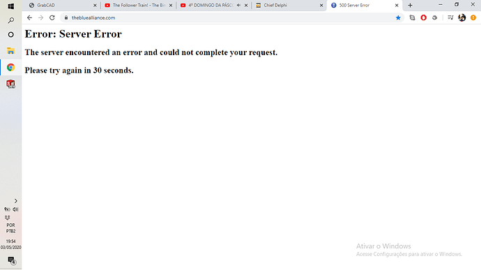

TBA down
Should be back now - my bad. I’m testing out some stuff around moving off the old python2 runtime with … destructive consequences.
