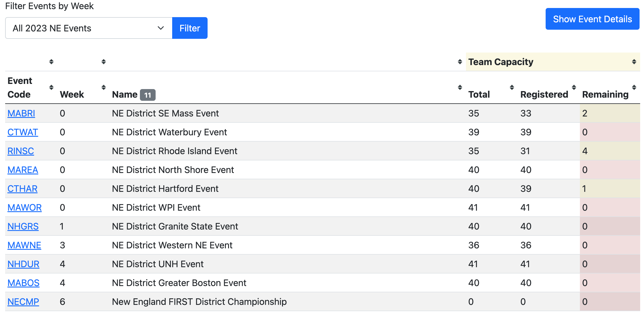

I’ve noticed that TBA for New England hasn’t updated since before Pine Tree was gotten rid of, I know its because of how FIRST displays stuff, and where on the website TBA is pulling, but is anyone else super confused? I keep having to go find lists on FIRST, to see who is actually going to which event. I just wanted to make sure I’m not the only person to have noticed this.

Makes sense. I figured they pulled from different places. Now it seems FIRST is having some trouble with NE. All of those Week 0’s… aren’t week 0’s.
