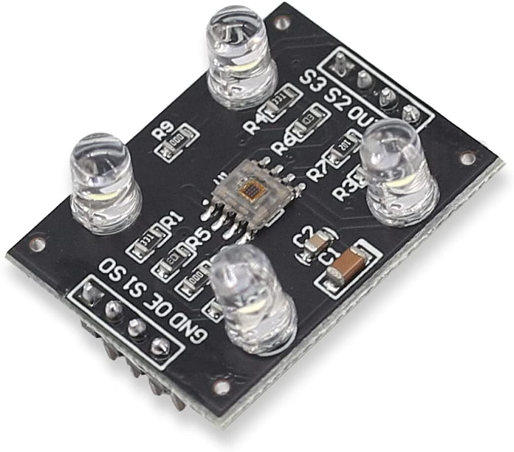

TCS230/TCS3200 Color Sensor on RoboRio
Has anyone used one of these TCS230/TCS3200 Color Sensors on the RoboRio with Java?
Amazon.com: SEEU. AGAIN TCS230 TCS3200 RGB Light Color Recognition Sensor Detector Module with 4 LED : Electronics
It seems pretty inexpensive and I am a little afraid of using the Rev based on some of the I2c issues that have been reported.

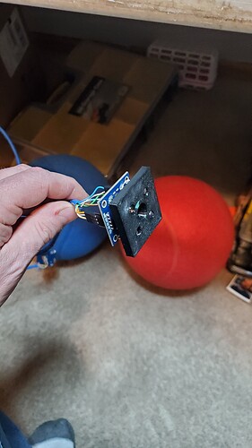

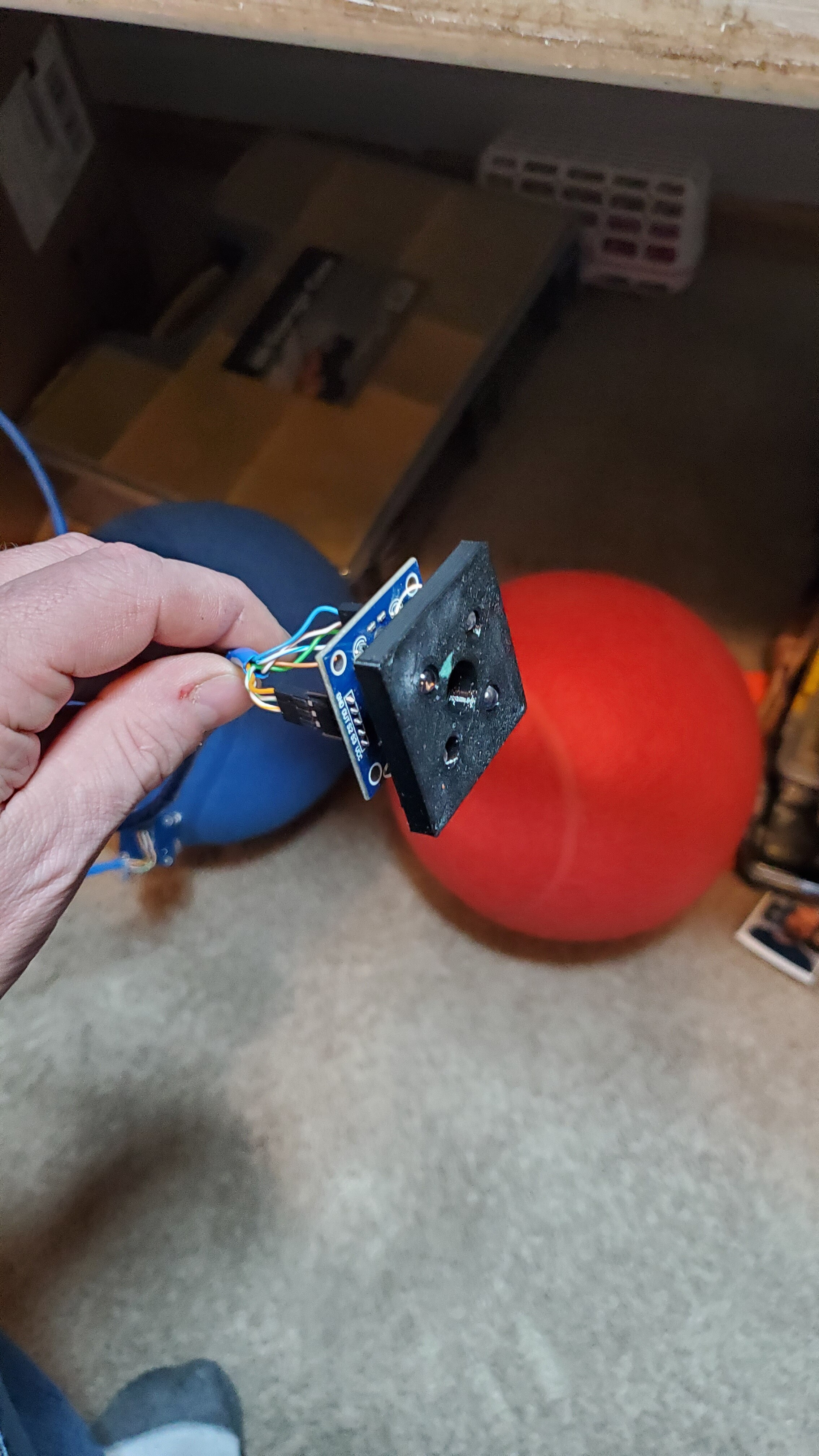

It appears you can get that same breakout board from other distributors for cheaper then Amazon. One other note is that the Arduino article shows using a blinder for sensor. That would probably be smart to implement.
Make sure to test this under a few lighting conditions. Take a look at the spectral response from the datasheet:
One concern I’d have is if there is enough infrared blue can start looking like red. Maybe the one on amazon with a ‘lens’ to block out the light (or 3d print something) could help?

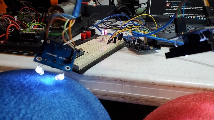

I been working on this for a few days. My goal is to connect them to my CheesyArena for auto scoring. I’m using an Arduino to drive the signals and have had the Arduino driving DIO on the Rio.
Now that @Joe_Ross pointed out the function of the counter I’ll give that ago too.(for robot integration)
RGB LED’s in the background are displaying the different sensors current detection.
