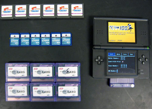

The program was written in C using the DevkitPro development environment and the PAlib Nintendo DS library functions.
There are three required hardware parts (aside from the DS):
SD Card: Any card above 2mb will work… but the smallest card available in stores (at this moment) is 2gb. This is where the program and all of its files, including pictures of the robots, are saved.
Super Card: This converter device takes a SD card and turns it into a GBA card, They’re available from “http://realhotstuff.com
Super Key: This is the device which bypasses the security on the DS, allowing non-Nintendo approved cards to be run. This is also available from http:;//realhotstuff.com.
DevkitPro (and associated instructions for installation) are available from http://www.devkitpro.org/ and http://palib.info/wiki/.

Required Parts:
  • SD Card (6) –formatted Fat16
  • Super Card (6)
  • Super Key (6)
  • DS (6)
  • Memory Card Reader (1)
  • Computer (1)

    Make sure that all the SD Cards are set to FAT16 (reformat them if not). Then, place the DS.txt, output.txt, and Team100Scouting.sc.nds, and the entire image directory files onto each DS card.
    Place the SD card into the Super Card. Then insert the Super Card and Super Key into the DS. Turn on the DS and toggle to the Team100Scouting.sc.nds file and run by pushing the A button.

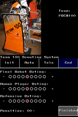

There are four tabs on the main display: initialize, autonomous, teleoperated, and final assessment. Touching the ball numbers increments the count while touching the minus number decreases the count. We included a checkbox for robots that are no shows or disabled during the match. The system automatically loads the match list from the CSV file, to automatically assign each DS a team to scout. If needed, uncheck the Load From File checkbox to manually enter the team number.
When moving to the Autonomous tab, the robot picture will now display on the top screen. After the match is over, and the robot has been ranked, pushing the “finished” button in the lower right corner of the END screen will save the data to the output.txt file and the match number will automatically increase. If the DS is powered off, just scroll back to the match number needed.
