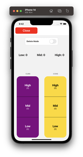

One thing after having been in the game for as many years as I have (although some people have many more seasons logged) apps almost always have WAY too small of touch targets. I want my scouts to have their eyes on the field, not on the app. How many the 114 solution be best positioned over other apps to address this concern of mine?
We’re going to try and go the Signal route. All data will be encrypted across a team, but the way it is encrypted and the code for our actual platform will be completely open-source, so anybody can review it (and improve it!).
As for touch targets, I’m really glad you mentioned that. UI/UX is a top priority for us, and we focus heavily on that, especially for the mobile experience. We strive to design exactly as you mentioned, minimizing the need for scouters to look at the actual screen as much as possible. Here’s an example of what we did for this years’ game:
We intentionally made the height that ratio of the screen so it is easily reachable by thumbs. Each different level (low, mid, high), has a unique haptic feedback associated with it, so scouters can increment it with confidence knowing they selected the right one.
We have this guide for how we design our scouting experience, that keeps the scouters as our first priority:
  1. You should not have to look down whilst scouting
    1. Looking down gradually increases both cognitive burden and annoyance with scouters
  2. Maximize data, minimize input
    1. Scouters do not like having to type – most of the time, they are repeating the same thing over and over again across several robots.
    2. Having preset options would allow them to only have to put in 20% of the effort, but we reap 80% of the benefits
  3. Optimize for short-term memory
    1. Data in non-chronological order is dangerous; scouters forget what happened very quickly
    2. Basically, you have to let them input information as fast as possible
  4. Make it visceral, visual
    1. Excessive text takes time to read and can be repetitive as scouters work for hours on end.
    2. Create more engaging, text-less visuals
  5. Fast
    1. Don’t waste time with animations everywhere.
    2. Make a seamless experience that allows scouters to enter data as fast as their minds allow them to.
