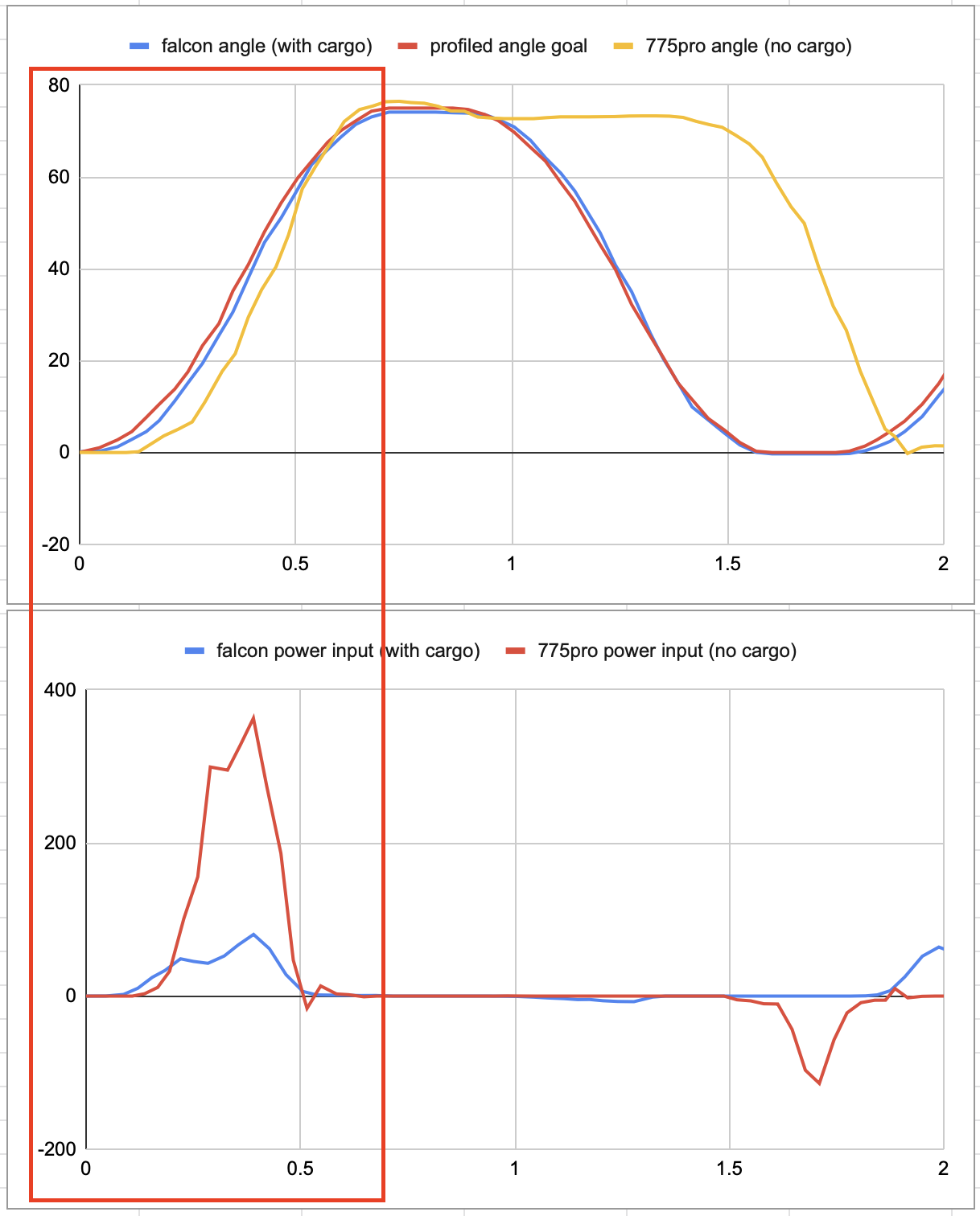

When the motion profile was tuned to aim for a similar speed and acceleration (making the falcon peak at 6-ish V) as the 775pro wrist, the falcon proved far more efficient.
A power input comparison (W vs time (s) and deg vs time (s)):
Nearly the same position vs time for both wrists (in the red box), but the Falcon one is a bit faster with more load (carrying a piece of cargo). This means the Falcon wrist is following a harder energy path. Yet, the falcon needs about 25% the peak power input.

This is great data, thanks guys! That wrist joint comparison is awesome. Definitely a stark difference between the two. Was there any Falcon vs NEO testing done?
