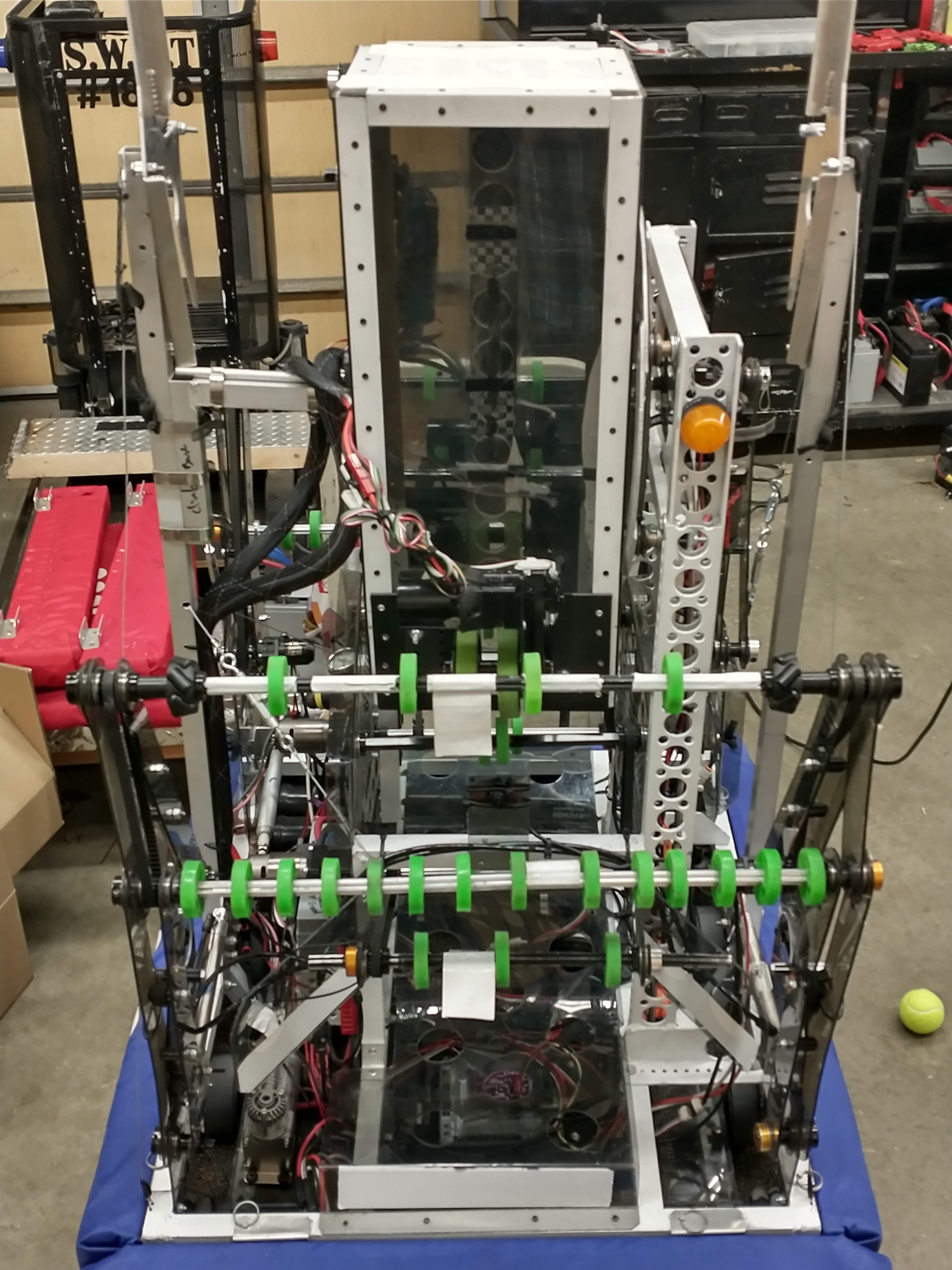

Team 1806 2022 Robot, and 2022 Offseason Projects
Team 1806 2022 Robot: BACKFIRE
CAD (Still being cleaned up)
Code
Pictures
Features:
  • Dual ground intakes
  • High hub shooting from the front or back
  • 6 NEO 8 wheel west coast drive with shifting transmissions
  • Feed through for getting rid of cargo of the wrong color
  • 2 cargo high hub autonomous
  • Mid-rung everybot climber with bar lock-on
Accomplishments:
  • Creativity Award at Greater Kansas City

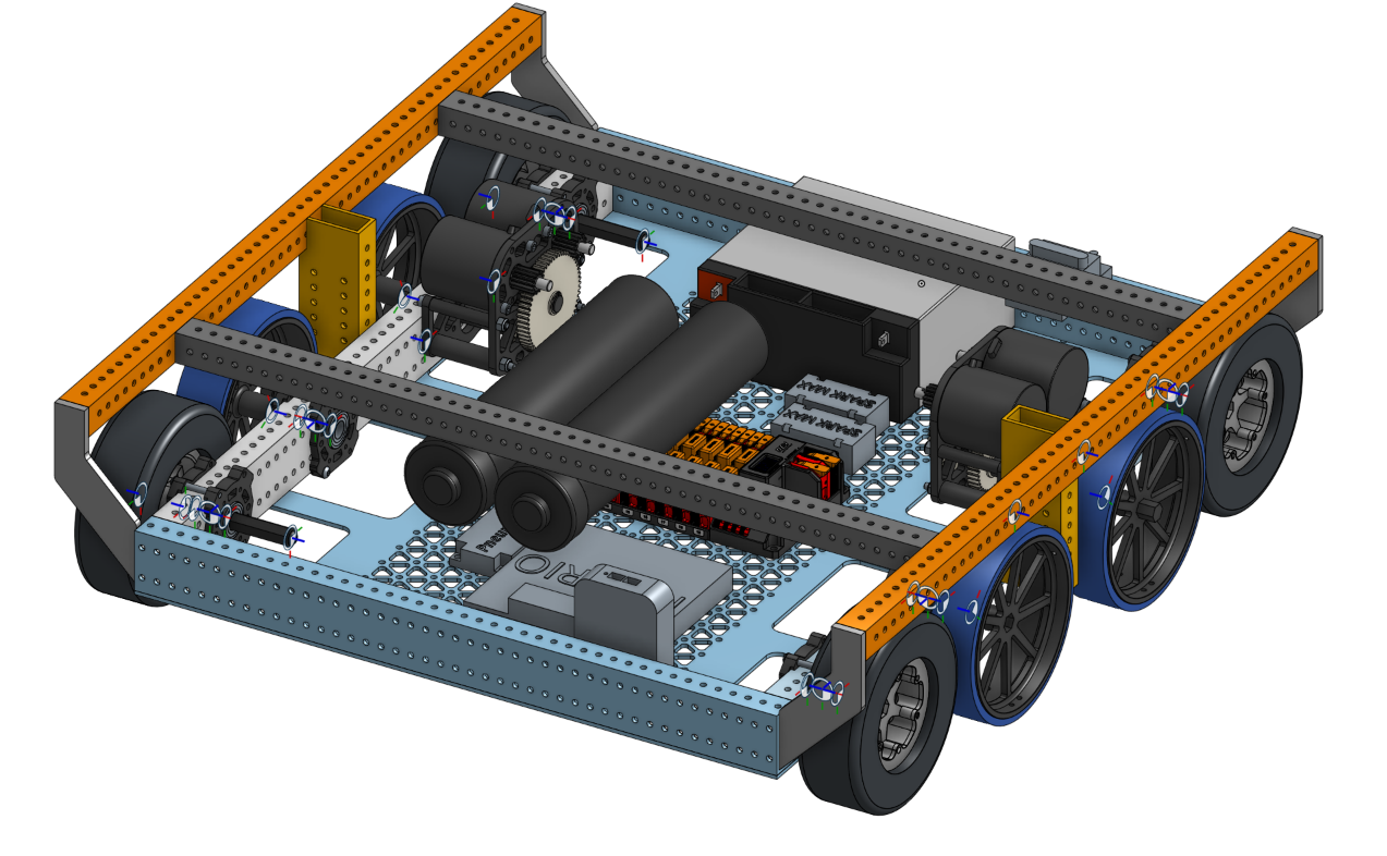

Team 1806 Offseason Project 22X
Project 22X is a design for a small 6 wheel drive, 6" wheel west coast drive. The wheel layout is inspired by team 1678’s 2020 robot with pneumatic wheels on the front and back, and traction wheels in the middle. No pictures yet as the assembled frame has been waiting for parts to arrive since before Halloween.
CAD
Code (WIP)

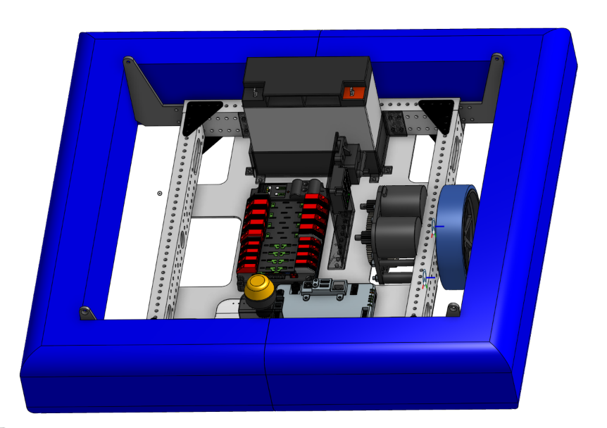

As a variant to 22X, 22XB is an 8 wheel drive 27" X 27" drive base with some modifications to the build style to bring it back somewhat closer to what team 1806 traditionally does (see our 2022 robot)
CAD
