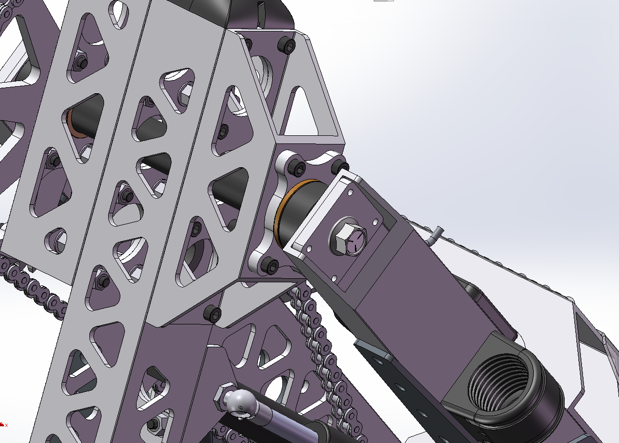

Were there any issues with shearing of the 1/8” box beam for the top pivot point attachment? Was that point reinforced at all?

Yes, we did reinforce it. On our practice bot, we did notice a crack had formed and noticed the tube wall had deformed a little so as a precaution and to improve the rigidity we mounted a 1/4" aluminum plates with four 8 bolts.

How do you bolt on the top plate? It doesn’t look like enough material to tap and I don’t see enough room to have a nut.
Ya, it doesn’t look like enough you get about 1 thread (1/4-20), but it was just holding the plastic cover on. As long as you’re careful when screwing it on (DON’T STRIP IT) it holds up totally fine, they never came out for us even with really hard hits. Those bolts were an afterthought and they were originally intended to be held on by the slight interference fit of the top cover. In the future, we plan to add a boss to the lower cover and put a heat set insert in to hold the top cover on.
