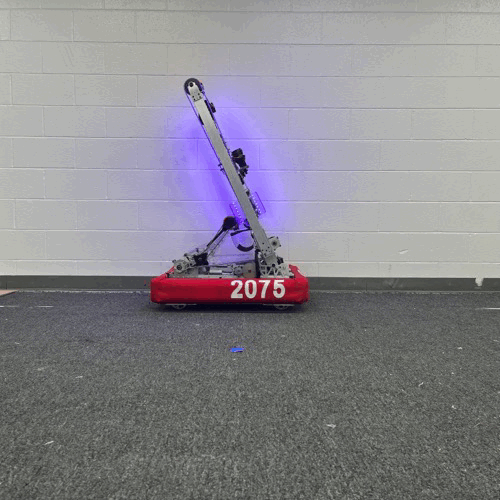

Team 2075 is proud to present our 2023 robot: Cypher
Robot Positions

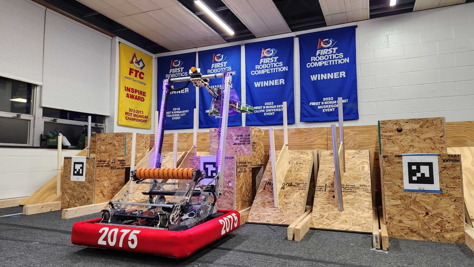

UPDATE SINCE MUSKEGON EVENT
Changes:
  • Optimized drivetrain using Phoenix Pro
  • Implemented Limelight localization for autonomous
  • Improved ground/cube intake
  • Improved shoulder and elbow backlash (clocked steel gears and Loctite 680 to fill gaps between gear bore and hex shaft
  • Added better handles for carrying
  • New and improved autonomous routines (see video below)
Excited to compete with everyone at MSC! Good luck to all teams.
